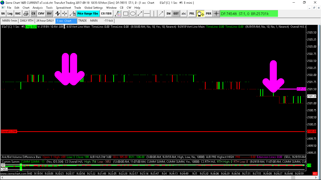

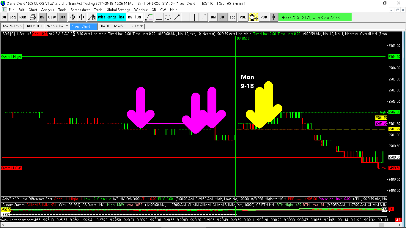

For me the studies this happens to is typically the "Colored Bar based on Alert Condition". In this particular chart, that study is applied to a Cumulative Study of the Ask/Bid Difference.
1. Here you can see the Yellow Arrow covers up the price bar. The settings are "Input Data=High" and "Ticks offset=0". Any Arrow size set to higher than ~4 covers the price bar. So you can see it truly isn't at the "High".

2. Here you can see the Magenta Arrow not only covers the price bar, but the extension line covers the Value Label. The settings are "Input Data=High" and "Ticks offset=0" and "Value Label=Right Edge" . I need to see the level that the arrow goes off at. Yes, I know I could set the Value Label to the "Values Scale", but I simplified the chart a lot for your view, and that would add to already a lot of labels in the value scale.
Thx
http://www.sierrachart.com/image.php?Image=1505745318734.png

1. There is not anything further we really can do about this because this has to do with the thickness of the Draw Style. Modify the Tick Offset to what you require. You can also create your own custom study.
2. We will solve this. But you also can adjust the vertical alignment of the label to prevent the overlap. Refer to:
Chart Studies: Subgraphs Tab >> Name and Value Labels
