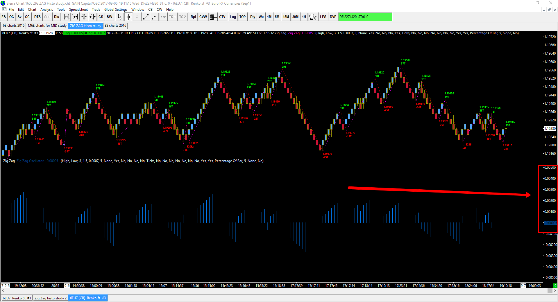

User97684 - Posts: 136
Hi , please help
The zig zag oscillator has half the tick lengths as compared to the zig zag line over the price chart. I.e. 79 tick long line, we get a reading of 40 on the oscillator.
Also , please can I print the swing sizes on the tops of the oscillator triangles ?
Many thanks,
Best Regards
imagezig_zag_oscillator.png / V - Attached On 2017-09-06 17:46:35 UTC - Size: 88.72 KB - 2183 views
[2017-09-06 18:04:13]
Make sure you understand what the tick size is for that particular symbol. It is .00005
You could use this Draw Style:
Chart Studies: Value of Subgraph (ACSIL: DRAWSTYLE_VALUE_OF_SUBGRAPH)

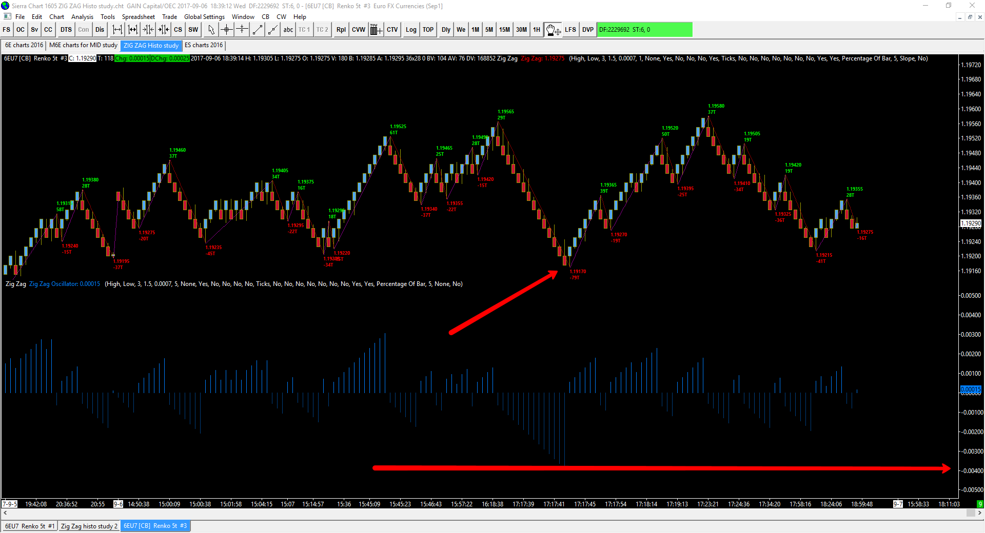

[2017-09-06 18:15:44]
Thank you for the quick answer!
PLs hlp - how could I change the value scale in chart region 2, for the oscillator, to show the correct ticks ?
Much appreciated,
Regards

[2017-09-07 03:01:10]
In response to post #3, you could use the Study Subgraph Divide study to divide the Oscillator Subgraph by the tick size. Refer to:
In response to post #4, this is possible by adding another instance of the Zig Zag study set to work as an oscillator and then using this particular Draw Style:
Date Time Of Last Edit: 2017-09-07 03:02:33
