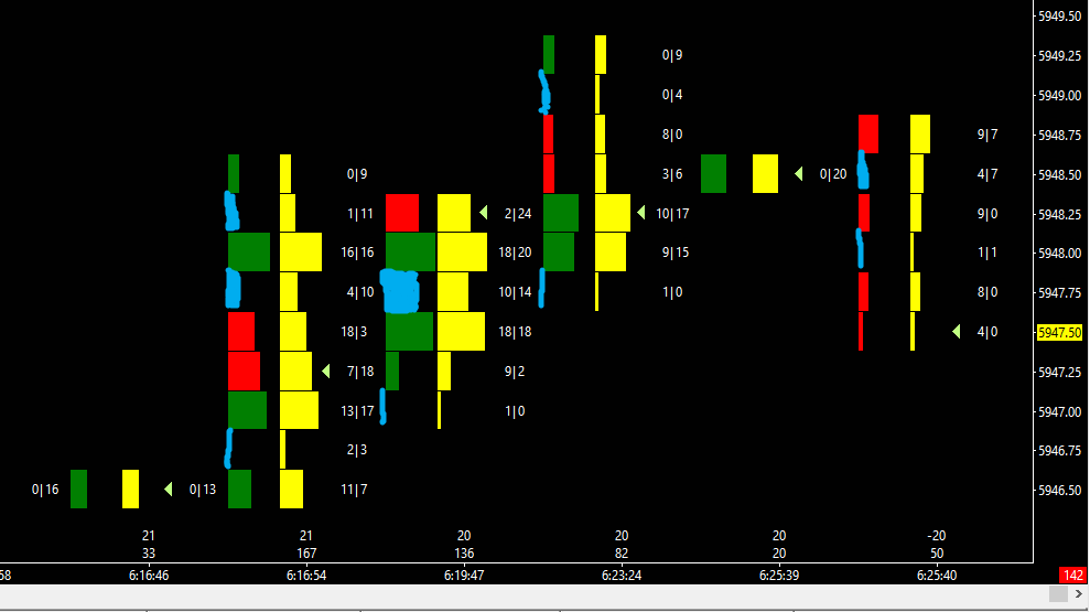

When using a diagonal comparison on a numbers bar and coloring it, one loses information of what happens in uncolored rows. Is there a way to put a neutral color row in so we don't have to make another column with redundant information just to see what happened in the missing row?
http://www.sierrachart.com/image.php?Image=1504150177564.png

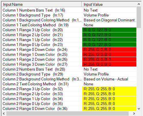

Sorry, I have not been able to articulate myself better. I have spent a tremendous amount of time reading the documentation over many days. Could you look at this pic please?
Do you see how the yellow number bars are identical to the green/red ones?
Attached are my settings. How can I add rows to the green/red bars to give them the same shape as the yellow bars? This way I don't need to double the columns used just to see what the rules omitted.

[2017-08-31 11:17:08]
User99934 - Posts: 227
The attached pic shows in blue what I am referring to in post #8. I could not edit and upload pic using required upload method after editing pic.
I could then eliminate all the yellow columns and text because all the information would be in one column. I could double or triple the bars on screen to avoid needless duplication.

Basically there are two possibilities. We can add a default background color.
Or you can set the Column 1 Background Coloring Method to Based on Volume Percentage and use the same color for all eight of the colors for the first Numbers Bars column. Then use the Column 1 Text Coloring Method for the diagonal comparisons.
This way you will see always a complete Volume Profile when there is no dominant side on either the bid or ask side of a price level and therefore no Volume Profile shown.
Date Time Of Last Edit: 2017-08-31 17:02:04
