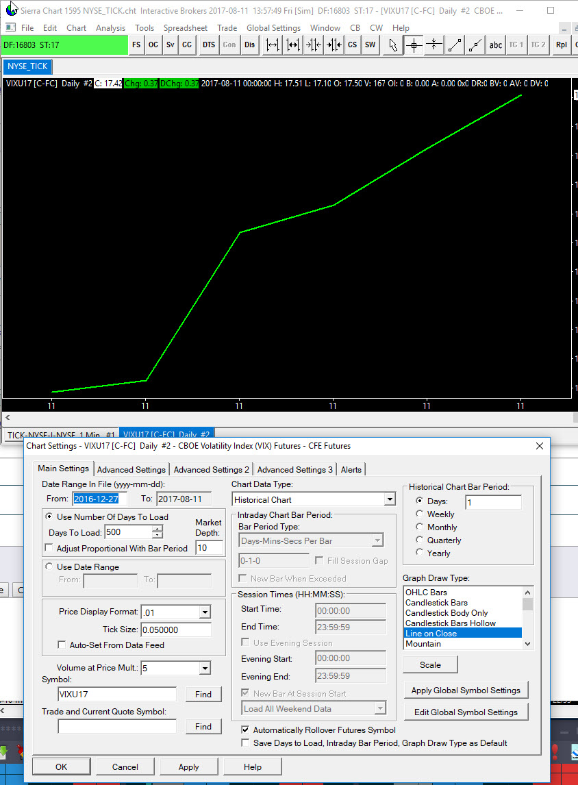

Hello SC,
i learned about the possibility to pull up a forward curve in SC just recently and found the documentation about it: Continuous Futures Contract Charts: Forward Curve Charts
i tried to pull up a VIX forward curve but failed to do so. What do i do wrong and what do i need to change to pull it up? see my settings in the attached screenshot.
fwiw, i tried it with the auto rollover futures setting as well.. still no luck.
thanks,
Andreas

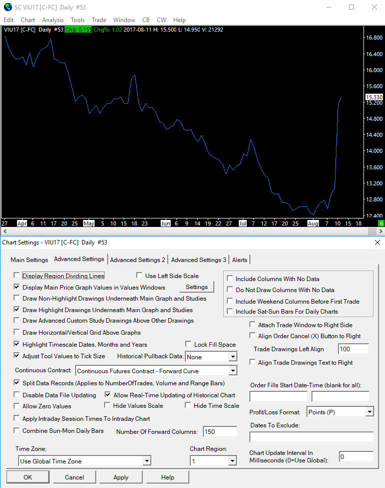

[2017-08-11 13:13:12]
Cavalry3162 - Posts: 523
this is what i see then
image2017-08-11_09-12-07.jpg / V - Attached On 2017-08-11 13:13:03 UTC - Size: 266.79 KB - 538 views

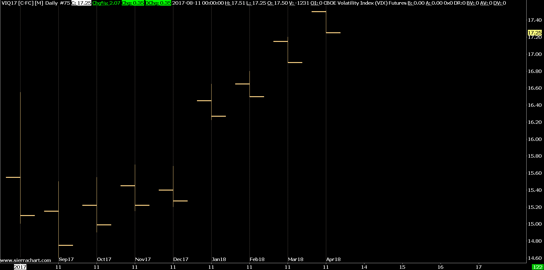

it kind of works with interactivebrokers, but not with those fancy expiration month names on the x axis....
image2017-08-11_09-57-59.jpg / V - Attached On 2017-08-11 13:59:18 UTC - Size: 284.24 KB - 573 views

You also need to enable Chart >> Show Rollover Dates.
[2017-08-11 17:49:22]
looks like rithmic doesnt have it... so, should SC provide it with its feed? i mean, i can chart a "time chart"... or am i missunderstand the concept?
rollover dates did the trick, thx for pointing that out.
