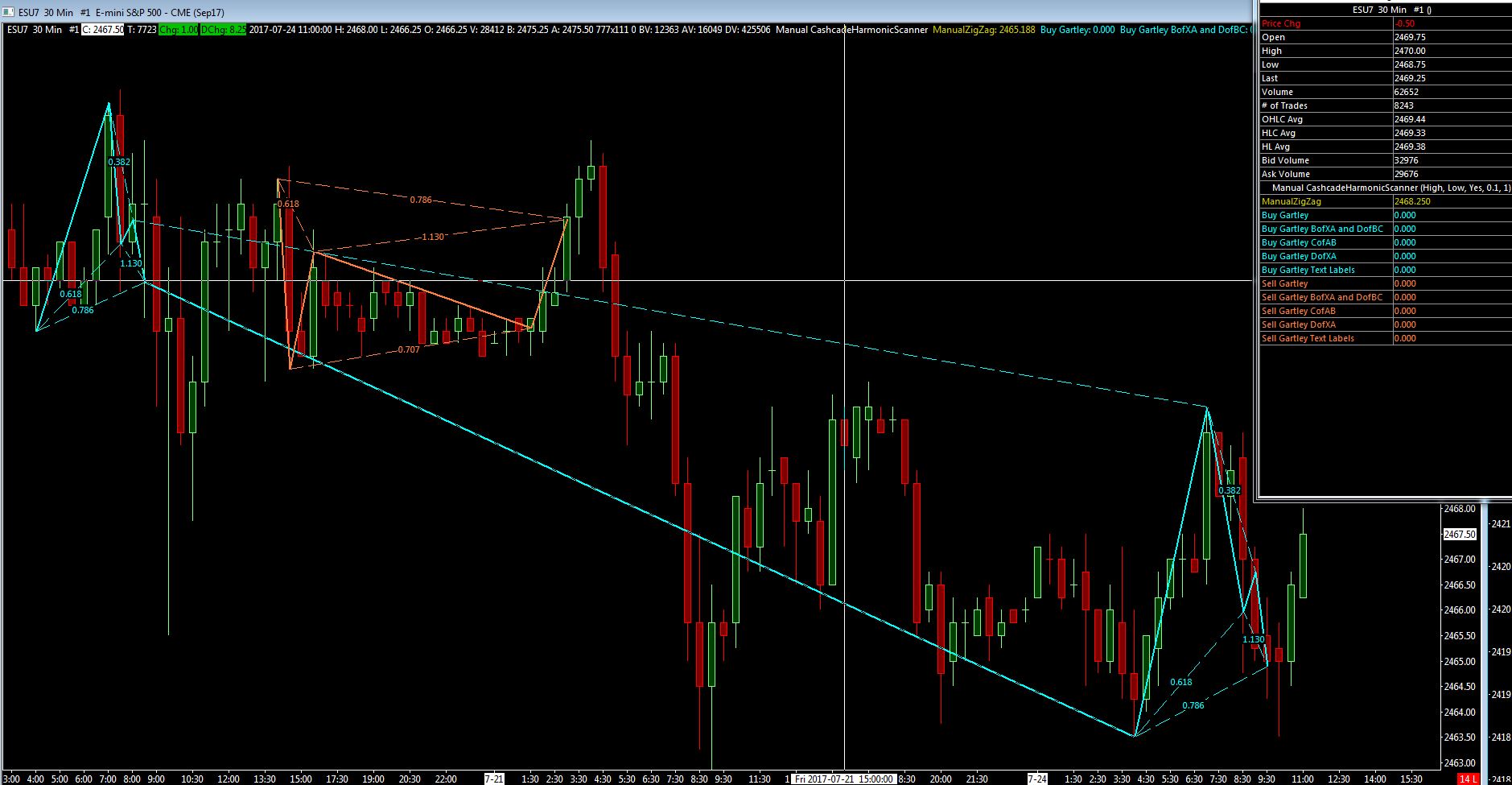

When there is only one drawn pattern visible on the screen, it displays correctly and the ".Drawzeros = false" takes effect. See attached "CorrectWithOneDrawing.JPG"

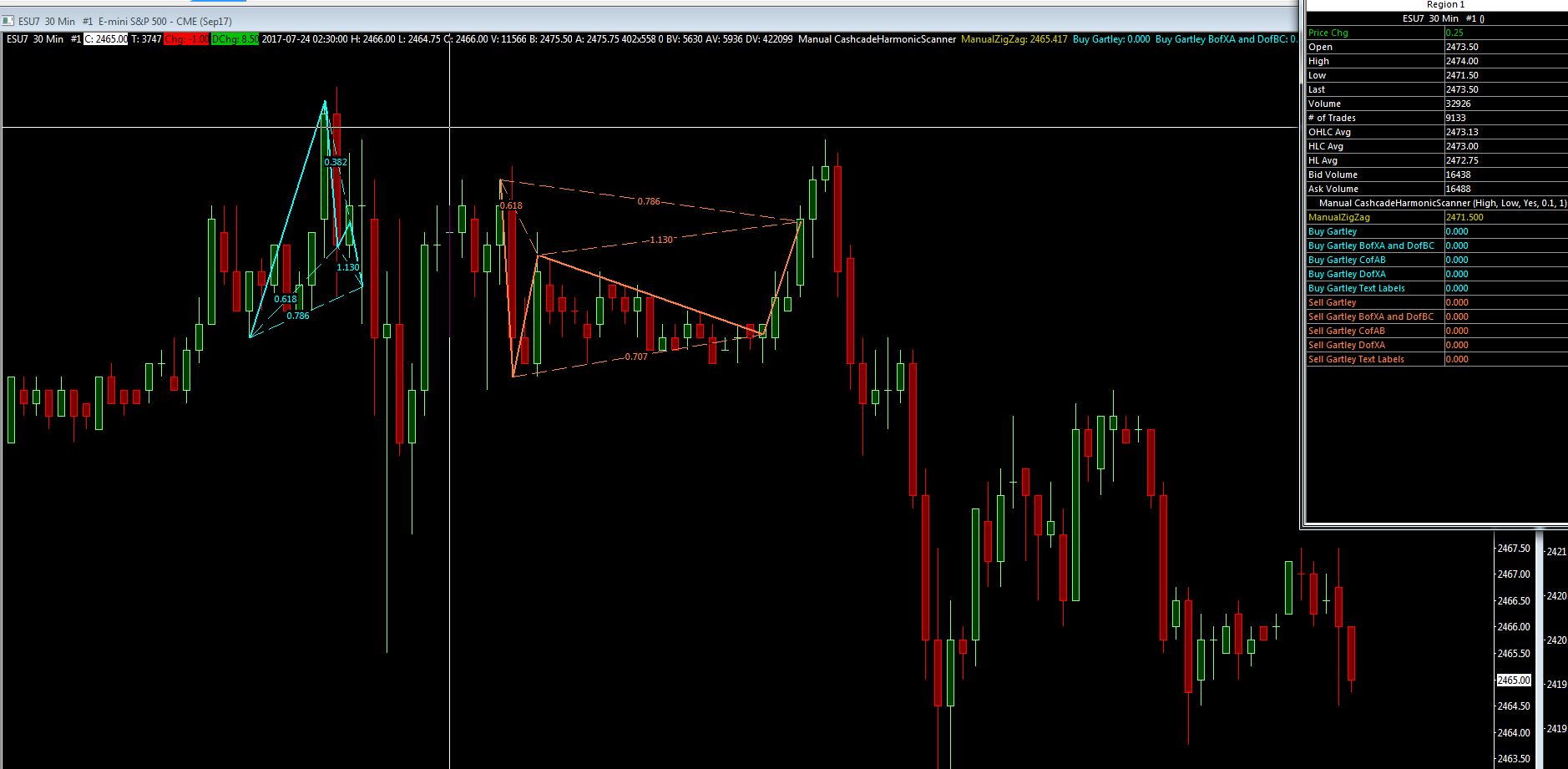

When there are two patterns visible on the screen, Sierrachart is drawing a connecting line. See attached "IncorrectWithTwoDrawings.jpg".
You can clearly see that in the Chart Values window, the subgraph .Data[] indexes are clearly zero, as intended by ".Drawzeros = false". However, SierraChart is still drawing a connecting line between the two patterns.
I've already tried to manuall set the .Data[] indexes to zero both before and after the subgraph array indexes that have values, still doesnt work.
Is this a bug? if so how do I work around it?

[2017-07-25 17:36:53]
That looks really nice. Are you going to make this publicly available?
We have answered this in the documentation here:
Chart Studies: Line (ACSIL: DRAWSTYLE_LINE)
You need to use Line - Skip Zeros.

[2017-07-25 21:41:26]
I didnt choose that initially because I didnt think the lines would be drawn between the vertices (of the "triangle") that also have zeros in between them.
Yes this is true and the solution to this is to set all of the points along the lines of a triangle.
