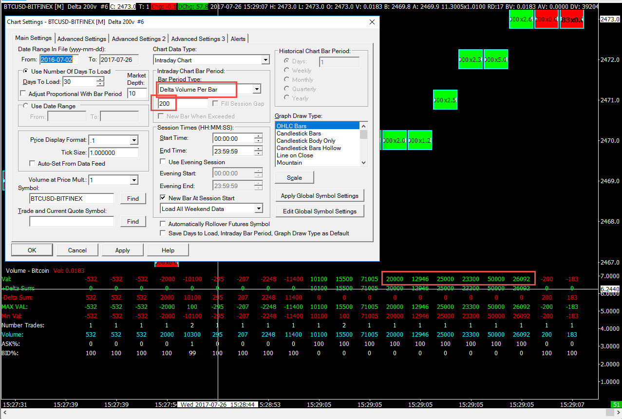

check please the attached screen shot where i set the btc chart to be delta chart for amount of 200 but since the trades done or tiny moves, the delta match the criteria which is causing wrong values
also it takes a lot of time to load / update chart when in delta modea
in min. time frame it's ok (seed)
pls advice
thanks

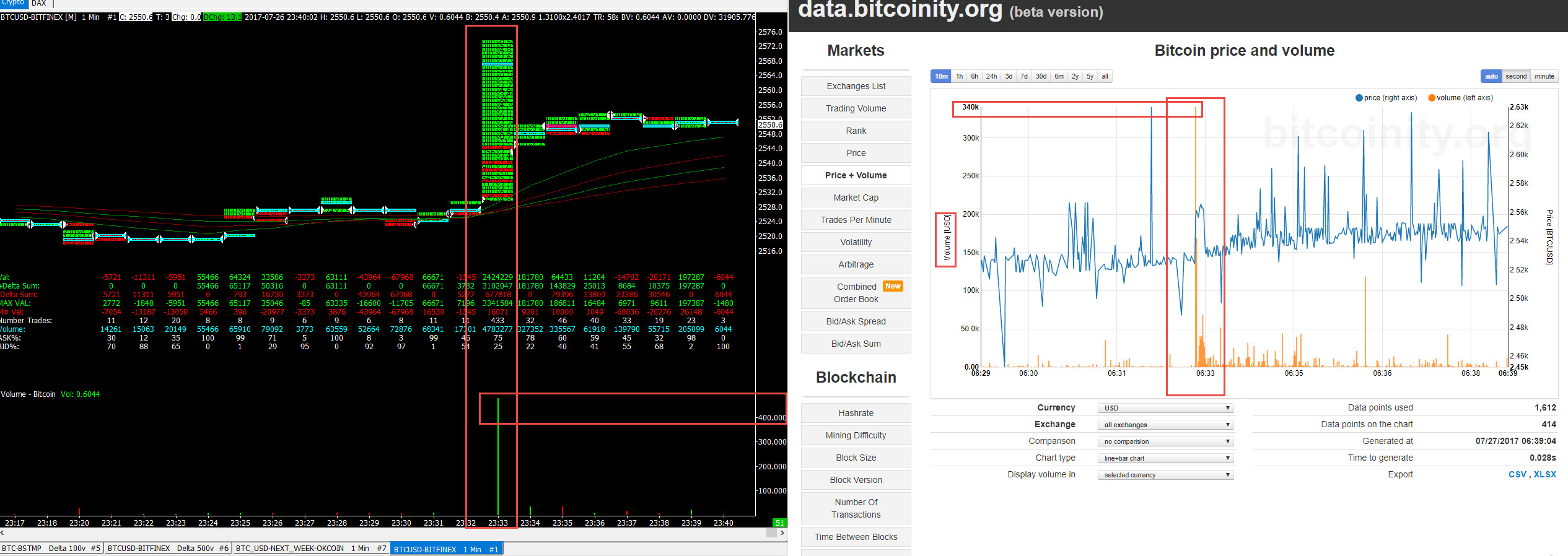

i am attaching another volume question
pls check the attached screenshot
on the left you can see a spike in the bitcoin and the volume is indicating on 478 units while the same spike in price is shown on the right side through another data collector where you can see the volume was 340,000$ (which is ~ 136 bitcoins)
so my question is again how this volume indicator is being counted
thanks!

[2017-07-27 17:21:11]
The only way to see the true volume for a Bitcoin/crypto currency symbol is to use the Volume-Bitcoin study.
The Delta Volume Per Bar Bar Period Type is not currently supported with Bitcoin/crypto currency symbols. It will be in the next release.
[2017-07-27 17:27:29]
In response to post #8, the Volume study shows the quantity traded for the duration of the chart bar. That is all we can say. Any other questions are outside the scope of our support.
In the case of symbols which use fractional quantities, the volume that Sierra Chart will report is not 100% exact. It will be slightly less. Perhaps it is underreporting it by 1%. Certainly not overreporting it.

[2017-09-10 19:41:41]
User61576 - Posts: 458
is there is an update for this issue?
thanks
[2017-09-10 21:01:45]
This has been released.
