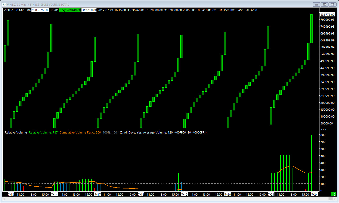

Ok, it doesn't seem to work all the time. for example, I am trying to compare the NYSE Issues volume total but it seems doesn't work. see image. thank you
imageRelative volume not working.jpg / V - Attached On 2017-07-23 17:10:39 UTC - Size: 242.51 KB - 467 views
[2017-07-24 03:52:15]
This study is not going to work with that type of data because that symbol contains no corresponding volume data in the Volume Subgraph.

ok, how do I compare the values of something like this with same period values from previous days. as I stated the thread, I also like to do this with ranges (example compare the 30 mins bar ranges with previous day, previous 10, --etc). Is a function for that? if not then can you help me understand or adapt a modification for Relative Volume study to do that. I believe it is important to be able to do this for daily preparations
[2017-07-24 15:51:43]
You will need to update prerelease 1588.
Here are instructions:
There is a new Input with the Relative Volume study named Volume Subgraph to Use. In the case of this particular symbol, set it to "Last".
We would have to do some testing, but with the latest addition to the Relative Volume study, you could probably do this by using the Bar Difference study and basing the Relative Volume study on that and setting the Volume Subgraph to Use Input to reference the Bar Difference subgraph.
