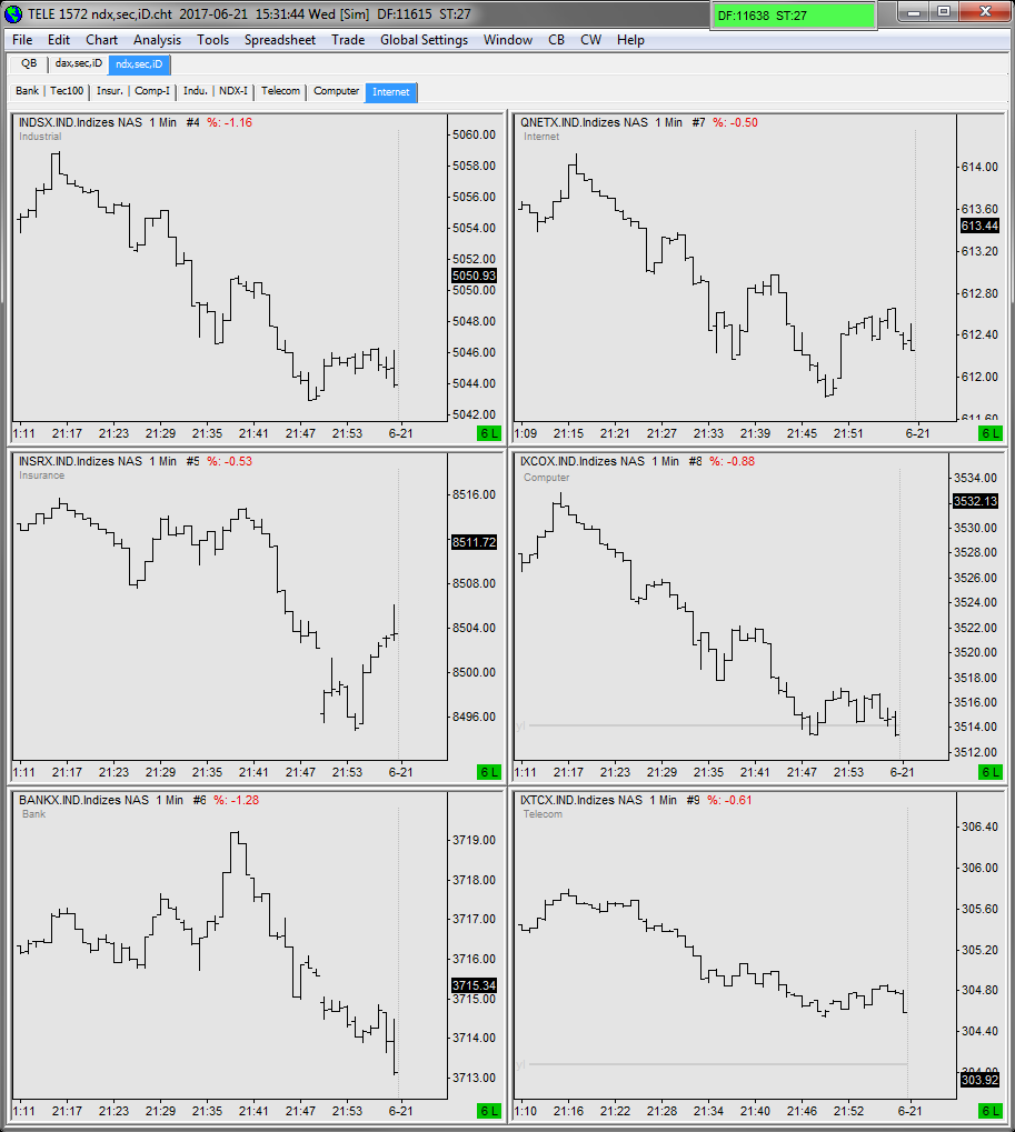

I'm using Teletrader Data Service to get realtime Dax- and Nasdaq Index and Sektor data.
Dax data is working fine, with Nasdaq data there seems to be a problem since a few days.
It does show the realtime data at the right-side scale / Last Trade Price Box, but it doesn't draw the bar.
I have not changed anything. Did work fine before.
imageNasdaq.png / V - Attached On 2017-06-21 13:54:04 UTC - Size: 71.05 KB - 465 views
imageDax.png / V - Attached On 2017-06-21 13:54:09 UTC - Size: 64.4 KB - 313 views

If you reconnect to the data feed, do the bars then appear?

tobi - Posts: 351
After reconnect the missing data appears (historical data is downloaded) but then again the bar is not drawn.
Please see the attached video for the behaviour.

We think the problem is that there is not last trade sizes or a timestamp being provided and that is what is leading to the problem.
We have made some code changes which should work around this.
We are now releasing version 1573. It will be out in a few minutes.
When it is out update with Help >> Download Prerelease.

The problem with the Tele Trader data feed, you can also verify this through Window >> Current Quote Window , is they are not sending through last trade sizes/quantities for the NASDAQ.
You should let them know about this.
We have released another revision of 1573 which is able to fill in the intraday volume and work around this issue, but they really do need to fix this.
