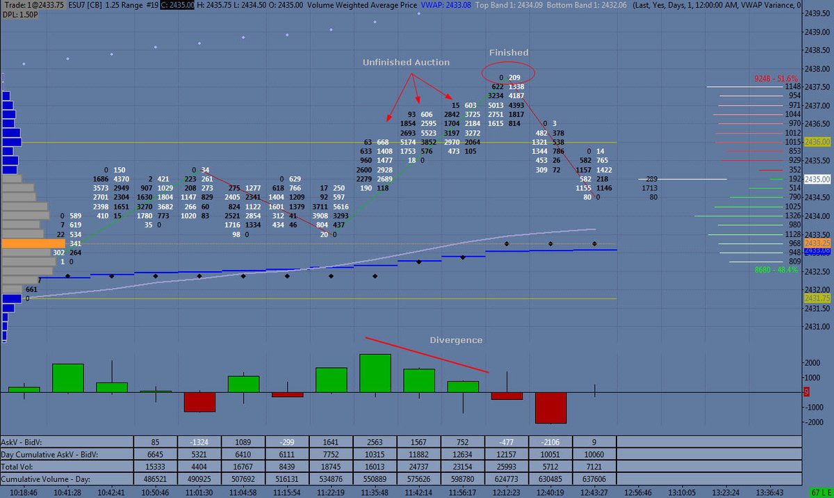

Cant figure out how to pin the Cumulative Delta to the zero line like the picture below. Can anyone help me with this?
imageESCDELTA.jpg / V - Attached On 2017-06-14 03:04:26 UTC - Size: 135.73 KB - 477 views

Looking at that chart, this is not supported in Sierra Chart.
The Cumulative Delta Bars study does function properly and in a proper way. You should not try to want it to function differently in a way which would not make any sense.

Can you please direct me on how to make it happen? Or are you saying its not possible with the tools readily available?

This seems to be a non-cumulative delta bar, that's what they all start at 0.
Not sure how it can be done in Sierra though

I think youre right. It cant be a cum delta bar. Im thinking perhaps its just the AskV - BidV turned into a bar

Figured it out. Thanks for helping me figure out I was searching for the wrong thing. Its a study called Ask/Bid Volume Difference Bars.

Yes, post #6 is correct.
We did not know that is what you wanted because you made reference to " Cumulative".
