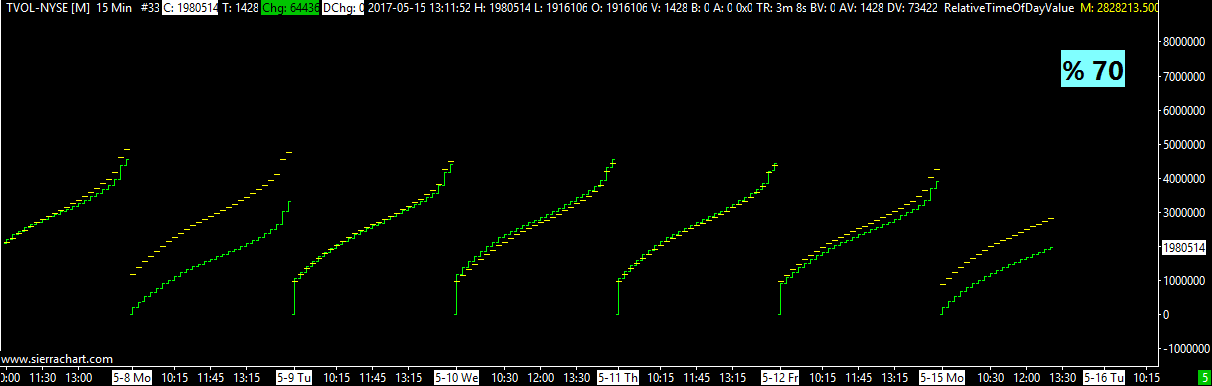

Please see the attached image and notice how in 5-8 and 5-15 the volume of the first period is different from the other days. The green line is the TVOL-NYSE data. The yellow line is based on the spreadsheet you recently helped me correct where I am looking at a moving average of each time period in the day. The data being inconsistent for the opening bar is throwing me off. It seems like either 5-8 and 5-15 are incorrect, or the other days are incorrect.
http://www.sierrachart.com/image.php?Image=1494871913421.png
[2017-05-15 22:08:46]
This is just a very slight one second timing issue.

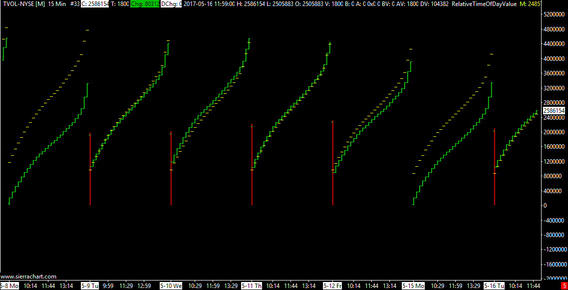

This did not fix it. Now I just see a stray red bar on some of the days

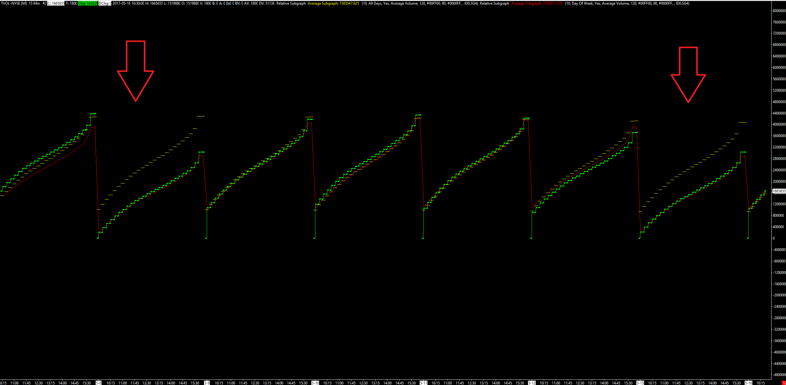

Rather than use a spreadsheet study you might like to test out the Custom study I have attached- "ReltiveStudyBeta" which uses the logic of the relative volume study, expect it can be used on any subgraph reference.
To get around the Monday skew, you could set the accumulation input to "dayofweek" so only equivalent time stamps for previous Mondays were used in the calculation. See image attached showing All days(yellow) vs same day of week( red)
This study should offer better functionality and efficiency vs a spreadsheet study.
