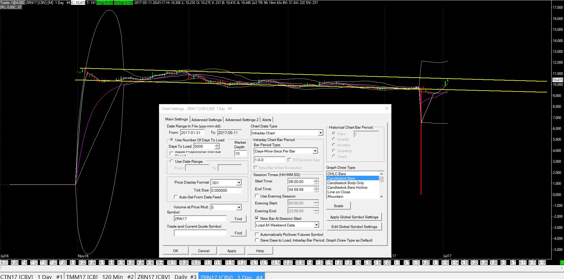

Problem on ZRN17 Daily data
View Count: 1160
[2017-05-11 12:42:51]
FH87 - Posts: 43
Data source from SC data service
what the problem ?
https://www.sierrachart.com/Download.php?Folder=SupportBoard&download=11978
image2017-05-11_2041.png / V - Attached On 2017-05-11 12:42:00 UTC - Size: 98.57 KB - 595 views
[2017-05-11 13:38:30]
This is an Intraday chart and is also using a back adjusted Continuous Futures Contract setting.
We want you to follow through the instructions here and re-download the data for all contract months:
https://www.sierrachart.com/index.php?page=doc/ContinuousFuturesContractCharts.html#ReDownloading

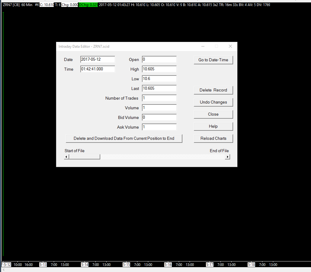

[2017-05-11 17:45:31]
FH87 - Posts: 43
try out that method...............still same case
i swicth connect mainly on Gain capital with SC data service.....worst now blank
even 1hr chart also cannot display
Data : Rough Rice
Date Time Of Last Edit: 2017-05-11 17:46:23
image2017-05-12_0144.png / V - Attached On 2017-05-11 17:45:07 UTC - Size: 30.86 KB - 361 views
[2017-05-11 21:19:32]
We need to set up this symbol for Gain Capital. We do not think it is set up.
We will follow up when done.
[2017-05-12 06:03:28]
This is because there are data multiplier inconsistencies for this symbol and we are cleaning these up. Will be done by the middle of the day tomorrow.
This symbol has now been added for Gain Capital. Update the Symbol Settings as explained here:
Global Symbol Settings: Update Symbol Settings
After that re-download the data in the chart with Edit >> Delete All Data and Download.
[2017-05-12 20:43:28]
The ZR futures data multiplier issue has now been resolved. You can re-download the data and you should be seeing correct data now.
