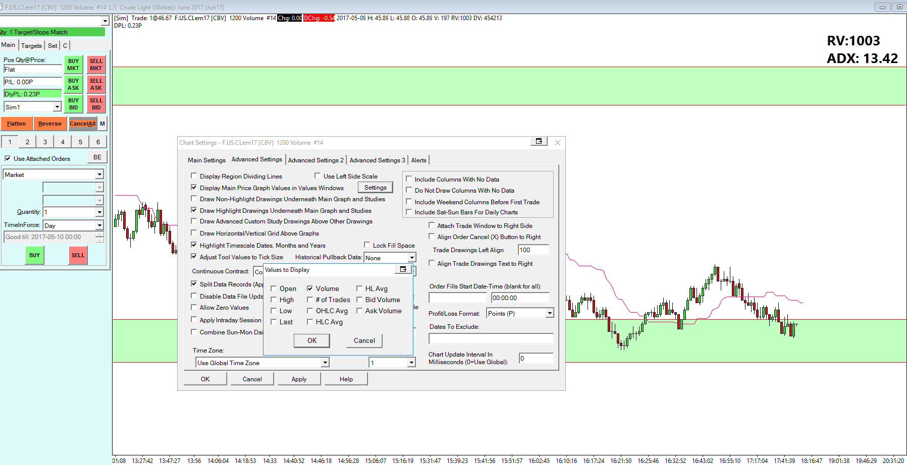

I only want to see the daily volume. I want to glance at this figure and not have to find whats going on in that long line of data. I went into the advanced settings and disabled all except for volume (as per the screenshot) but it ignores the settings change and everything just stays.

[2017-05-09 16:58:15]
That is the wrong place. You need to use Global Settings >> Customize Chart Header:
http://www.sierrachart.com/index.php?page=doc/GlobalSettingsMenu.html#CustomizeChartHeader
You also have the ability to reverse the color of the field.
You can use a larger text study, but that is more involved and less accurate.

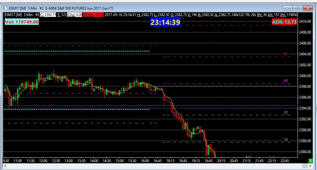

Grant,
I use the daily volume, attached is a screeny of my RTH /ES chart that shows the daily VOL in the upper left of the image.
It's simple to set up and is documented in the additional files page.
Additional Files (Study Collections, Spreadsheets, Chartbooks)
image5MIN_ES_RTH.jpg / V - Attached On 2017-05-17 03:18:23 UTC - Size: 221.16 KB - 776 views

[2020-08-19 16:22:54]
User173602 - Posts: 16
gjockey
It uses the following study:
Text Display For Study
Basically you're pulling a value from a different chart that has a study (and associated value) and displaying it as text on a respective chart of your choice. In this case I'm pulling the value for the ES on a daily time frame and displaying it on a shorter time frame chart as a text / numeric value.
[2020-08-19 20:25:23]
John - SC Support - Posts: 48480
You would have to have a separate Daily chart and then use the Text Display for Study from Chart study. Refer to the information here:
Text Display For Study from Chart
