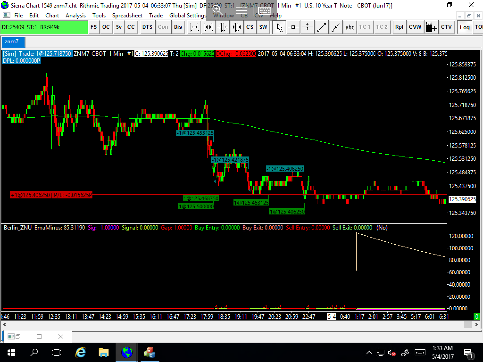

I'm running automated strategy in Sierra.
Unfortunately after connection to the server is lost then later after reconnecting the strategy start to calculate wrong values. It seems like move the decimal point to the left. Lets say multiple with 1000.I'm sending to you also screenshots.
Thanks for your help!
best regards,
vlad.
imageDatei_000.png / V - Attached On 2017-05-05 09:11:06 UTC - Size: 197.69 KB - 478 views
imageDatei_001.png / V - Attached On 2017-05-05 09:11:17 UTC - Size: 225.36 KB - 414 views

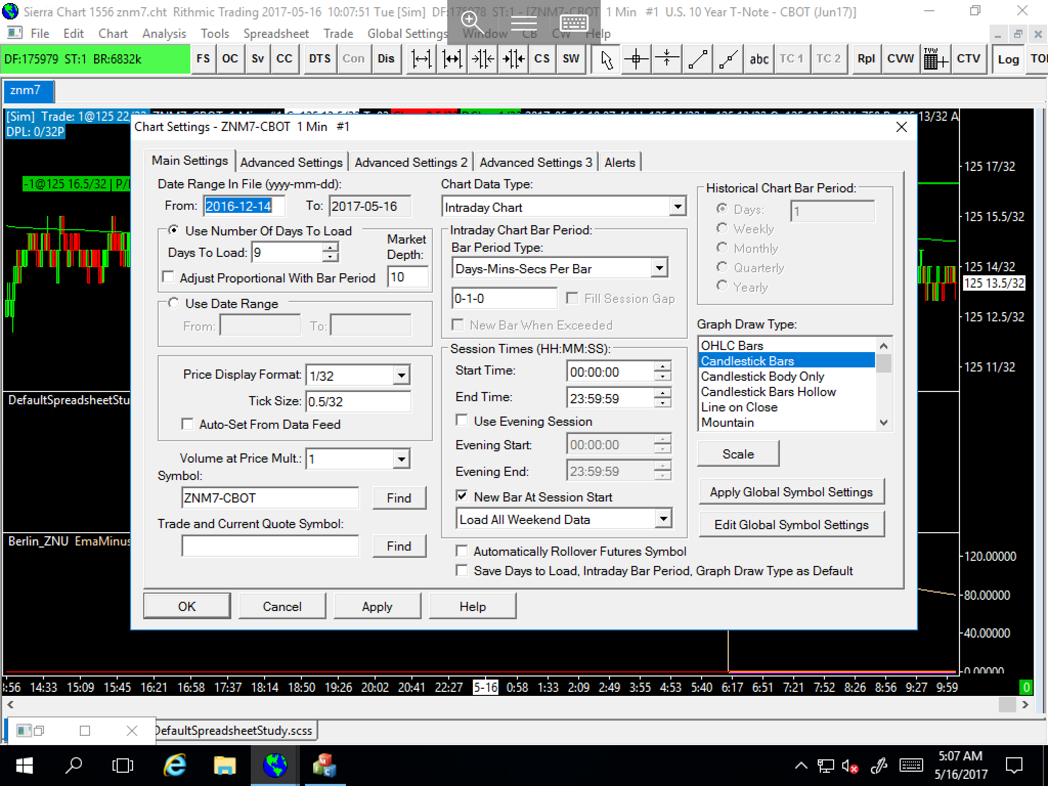

[2017-05-05 13:42:12]
Disable Chart >> Chart Settings >> Main Settings >> Auto Set From Data Feed.
And press the Apply Global Symbol Settings button, also in Chart Settings.
Date Time Of Last Edit: 2017-05-05 13:42:41

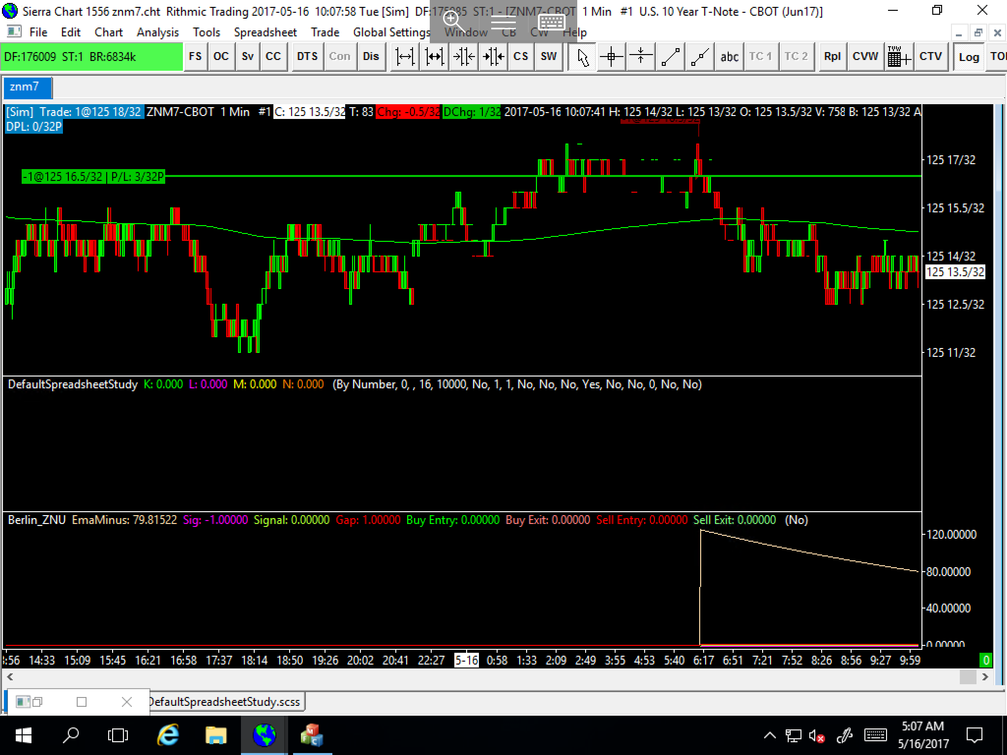

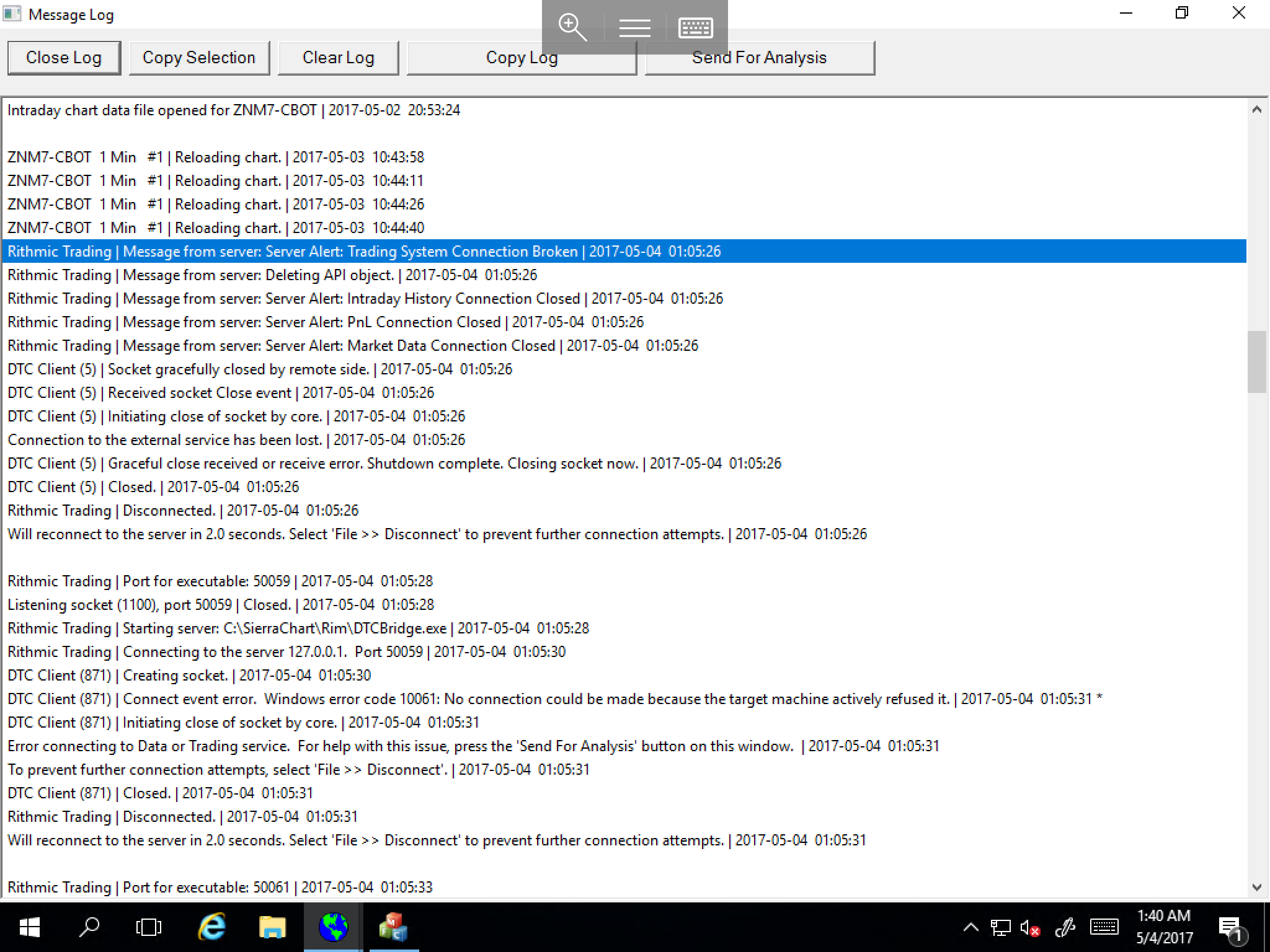

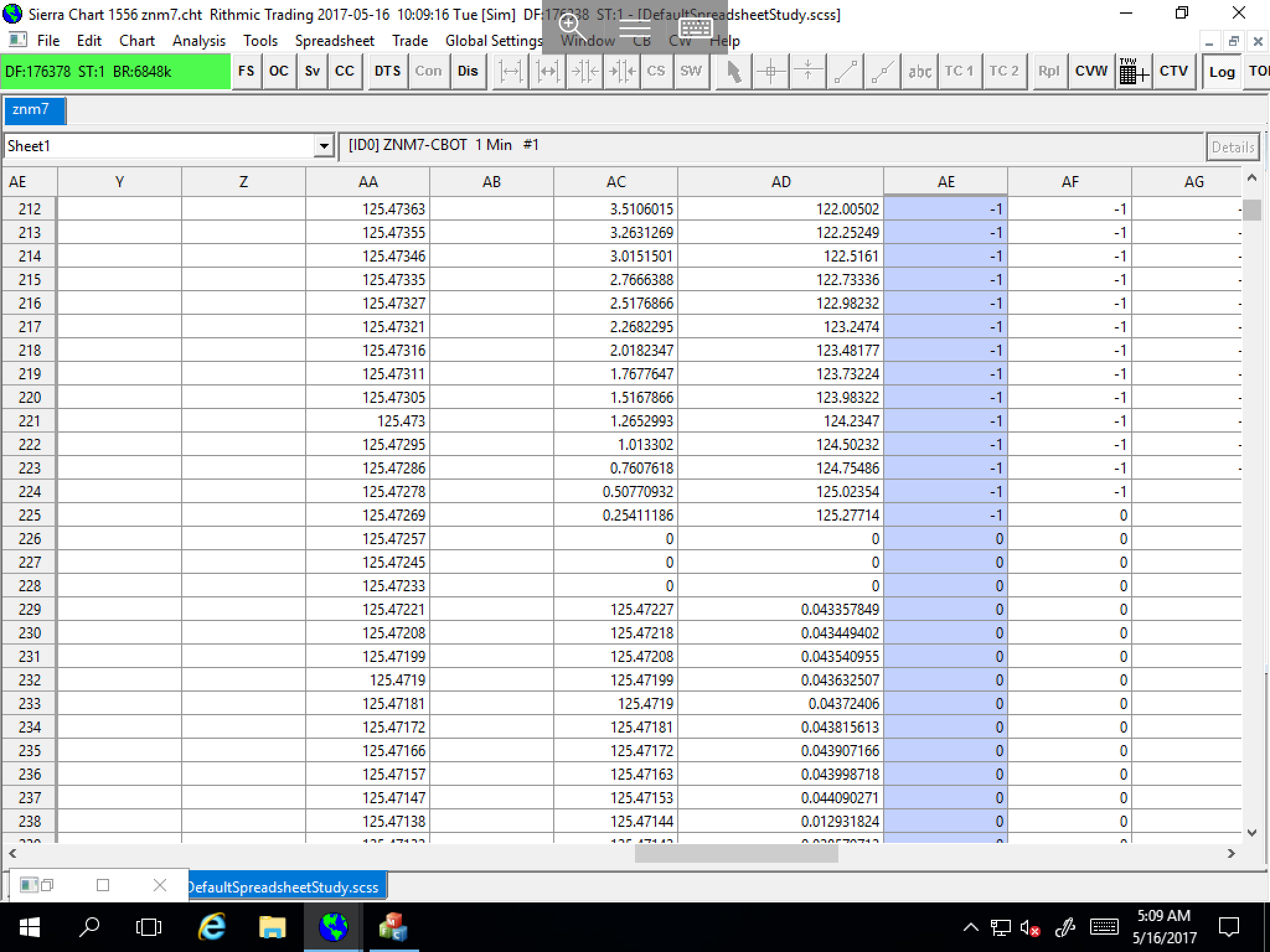

[2017-05-16 10:19:51]
User968787 - Posts: 8
Hi,unfortunately the error still persists. It happened few hours age again!
imageSierraError_01.PNG / V - Attached On 2017-05-16 10:19:28 UTC - Size: 240.49 KB - 464 views
imageSierraError_02.PNG / V - Attached On 2017-05-16 10:19:32 UTC - Size: 190.91 KB - 461 views
imageSierraError_03.PNG / V - Attached On 2017-05-16 10:19:36 UTC - Size: 206.19 KB - 463 views
imageSierraError_04.PNG / V - Attached On 2017-05-16 10:19:40 UTC - Size: 219.56 KB - 416 views

[2017-05-16 14:08:44]
I face still the same error like the one from 2017-05-05 09:11:51 post!
I asked:
best regards,
vlad.
You answered:
I made all the settings like you advised to me and started the strategy new. Few hours ago the same error! -Connection lost and after reconnected the strategy move the decimal point to the left!
Pls. let my know if this is now clear for you?
Thx.
Best regrads,
Vlad.
[2017-05-16 14:17:30]
If you see this on the chart, then post an image of a chart showing this by following these instructions:
Do not use any other method to post an image of the chart.
And tell us where on the chart you are seeing this.
Also it is not possible for the Value Format to change automatically if not using the Auto Set From Data Feed option, and makes no sense why such a thing would happen. So there must be some kind of misunderstanding.
Date Time Of Last Edit: 2017-05-16 14:22:39
[2017-05-16 14:27:31]
Why do you say "seems". Where precisely in the chart are you seeing this? Or precisely where else? At this point we do not know what you are describing.
Date Time Of Last Edit: 2017-05-16 14:27:49

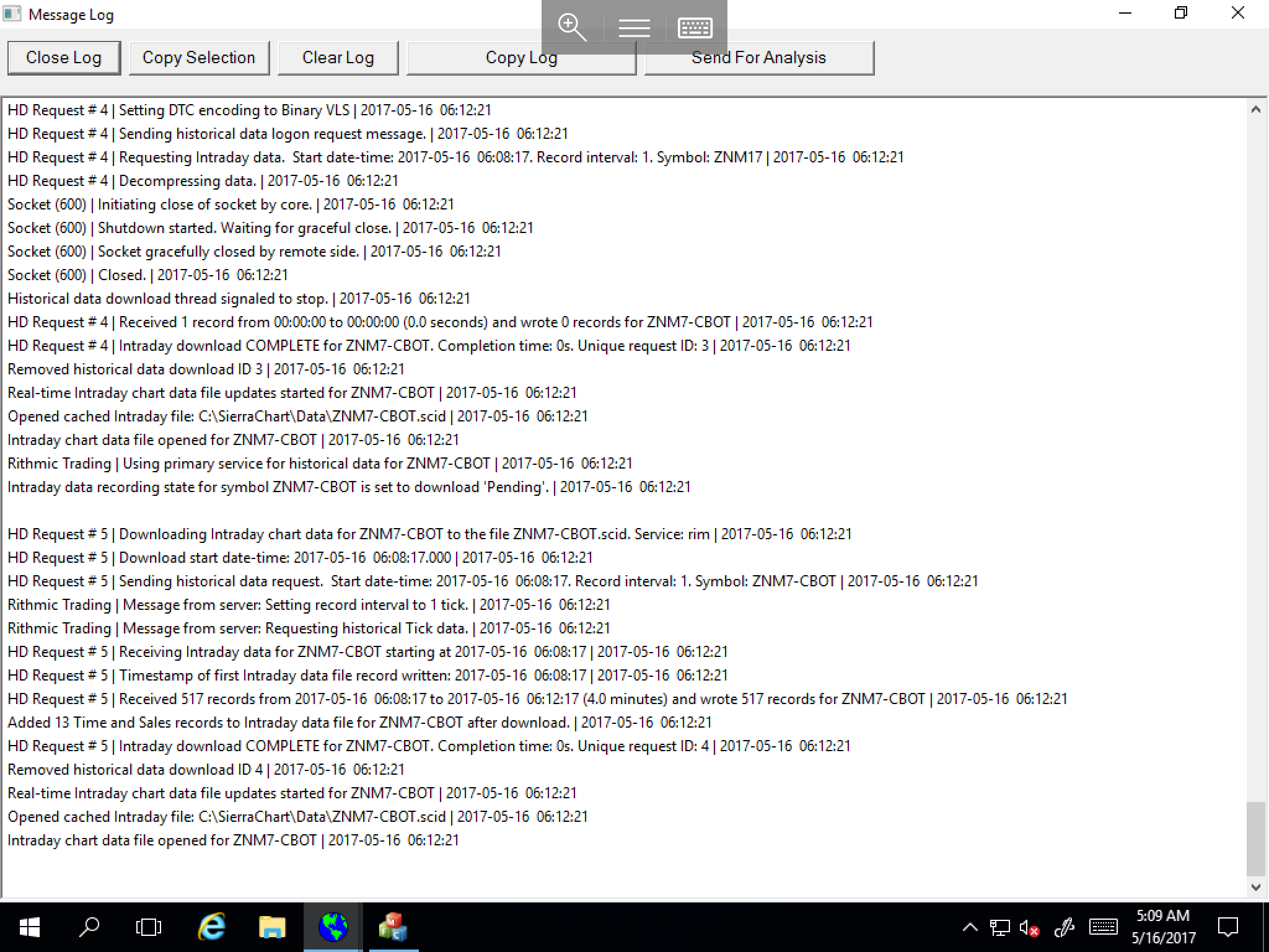

[2017-05-16 17:31:35]
OK. Understood.
Then I will send you log file.
to your answer:
Unfortunately this is happening.
Thx.

HD Request # 3 | Sending historical data request. Start date-time: 2017-05-15 10:57:52. Record interval: 1. Symbol: ZNM7-CBOT | 2017-05-15 11:07:52
Rithmic Trading | Message from server: Setting record interval to 1 tick. | 2017-05-15 11:07:52
Rithmic Trading | Message from server: Requesting historical Tick data. | 2017-05-15 11:07:52
HD Request # 3 | Receiving Intraday data for ZNM7-CBOT starting at 2017-05-15 10:57:52 | 2017-05-15 11:07:53
HD Request # 3 | Timestamp of first Intraday data file record written: 2017-05-15 10:57:52 | 2017-05-15 11:07:53
HD Request # 3 | Received 773 records from 2017-05-15 10:57:52 to 2017-05-15 11:07:46 (9.9 minutes) and wrote 773 records for ZNM7-CBOT | 2017-05-15 11:07:53
HD Request # 3 | Intraday download COMPLETE for ZNM7-CBOT. Completion time: 0s. Unique request ID: 2 | 2017-05-15 11:07:53
Removed historical data download ID 2 | 2017-05-15 11:07:53
Real-time Intraday chart data file updates started for ZNM7-CBOT | 2017-05-15 11:07:53
Opened cached Intraday file: C:\SierraChart\Data\ZNM7-CBOT.scid | 2017-05-15 11:07:53
Intraday chart data file opened for ZNM7-CBOT | 2017-05-15 11:07:53
Rithmic Trading | Message from server: Server Alert: Trading System Connection Broken | 2017-05-16 06:08:56
Rithmic Trading | Message from server: Deleting API object. | 2017-05-16 06:08:56
Rithmic Trading | Message from server: Server Alert: PnL Connection Broken | 2017-05-16 06:08:56
Rithmic Trading | Message from server: Server Alert: Intraday History Connection Broken | 2017-05-16 06:08:56
Rithmic Trading | Message from server: Server Alert: Market Data Connection Closed | 2017-05-16 06:08:56
DTC Client (4) | Socket gracefully closed by remote side. | 2017-05-16 06:08:56
DTC Client (4) | Received socket Close event | 2017-05-16 06:08:56
DTC Client (4) | Initiating close of socket by core. | 2017-05-16 06:08:56
DTC Client (4) | Graceful close received or receive error. Shutdown complete. Closing socket now. | 2017-05-16 06:08:56
DTC Client (4) | Closed. | 2017-05-16 06:08:56
Connection to the external service has been lost. | 2017-05-16 06:08:56
Rithmic Trading | Disconnected. | 2017-05-16 06:08:56
Will reconnect to the server in 2.0 seconds. Select 'File >> Disconnect' to prevent further connection attempts. | 2017-05-16 06:08:56

Rithmic Trading | Message from server: Server Alert: Intraday History Connection Opened | 2017-05-16 06:12:15
Rithmic Trading | Message from server: Server Alert: Intraday History Connection Login Complete. Result text: "ok" | 2017-05-16 06:12:15
Rithmic Trading | Received logon response. | 2017-05-16 06:12:15
Rithmic Trading | Server Name: SC DTC Bridge. | 2017-05-16 06:12:15
Rithmic Trading | Server protocol version: 7. Client protocol version: 7 | 2017-05-16 06:12:15
Rithmic Trading | Successfully connected. IB='AMP', Firm='AMPClearing'. | 2017-05-16 06:12:15
Rithmic Trading | Trading is supported. | 2017-05-16 06:12:15
Rithmic Trading | Order cancel and replace is supported. | 2017-05-16 06:12:15
Rithmic Trading | OCO Orders supported. | 2017-05-16 06:12:15
Rithmic Trading | Connected to data and trading server. | 2017-05-16 06:12:15
Rithmic Trading | Starting real-time market data updates for: ZNM7-CBOT. ID: 1 | 2017-05-16 06:12:15
Rithmic Trading | Requesting security definition data for: ZNM7-CBOT. ID: 1 | 2017-05-16 06:12:15
Starting first historical Intraday data download. When complete another download will be done from the primary service. Symbol: ZNM7-CBOT | 2017-05-16 06:12:15
Intraday data recording state for symbol ZNM7-CBOT is set to download 'Pending'. | 2017-05-16 06:12:15
Delaying start of download for ZNM7-CBOT | 2017-05-16 06:12:15
Delaying start of download for ZNM7-CBOT | 2017-05-16 06:12:16
HD Request # 4 | Downloading Intraday chart data for ZNM7-CBOT to the file ZNM7-CBOT.scid. Service: cbot | 2017-05-16 06:12:21
HD Request # 4 | Download start date-time: 2017-05-16 06:08:17.000 | 2017-05-16 06:12:21
HD Request # 4 | Using server: ds1.sierracharts.com port 10149 | 2017-05-16 06:12:21
Socket (600) | Creating socket. | 2017-05-16 06:12:21
Socket (600) | Connecting to IP: 8.18.161.135. | 2017-05-16 06:12:21
HD Request # 4 | Setting DTC encoding to Binary VLS | 2017-05-16 06:12:21
HD Request # 4 | Sending historical data logon request message. | 2017-05-16 06:12:21
HD Request # 4 | Requesting Intraday data. Start date-time: 2017-05-16 06:08:17. Record interval: 1. Symbol: ZNM17 | 2017-05-16 06:12:21
HD Request # 4 | Decompressing data. | 2017-05-16 06:12:21
Socket (600) | Initiating close of socket by core. | 2017-05-16 06:12:21
Socket (600) | Shutdown started. Waiting for graceful close. | 2017-05-16 06:12:21
Socket (600) | Socket gracefully closed by remote side. | 2017-05-16 06:12:21
Socket (600) | Closed. | 2017-05-16 06:12:21
Historical data download thread signaled to stop. | 2017-05-16 06:12:21
HD Request # 4 | Received 1 record from 00:00:00 to 00:00:00 (0.0 seconds) and wrote 0 records for ZNM7-CBOT | 2017-05-16 06:12:21
HD Request # 4 | Intraday download COMPLETE for ZNM7-CBOT. Completion time: 0s. Unique request ID: 3 | 2017-05-16 06:12:21
Removed historical data download ID 3 | 2017-05-16 06:12:21
Real-time Intraday chart data file updates started for ZNM7-CBOT | 2017-05-16 06:12:21
Opened cached Intraday file: C:\SierraChart\Data\ZNM7-CBOT.scid | 2017-05-16 06:12:21
Intraday chart data file opened for ZNM7-CBOT | 2017-05-16 06:12:21
Rithmic Trading | Using primary service for historical data for ZNM7-CBOT | 2017-05-16 06:12:21
Intraday data recording state for symbol ZNM7-CBOT is set to download 'Pending'. | 2017-05-16 06:12:21
HD Request # 5 | Downloading Intraday chart data for ZNM7-CBOT to the file ZNM7-CBOT.scid. Service: rim | 2017-05-16 06:12:21
HD Request # 5 | Download start date-time: 2017-05-16 06:08:17.000 | 2017-05-16 06:12:21
HD Request # 5 | Sending historical data request. Start date-time: 2017-05-16 06:08:17. Record interval: 1. Symbol: ZNM7-CBOT | 2017-05-16 06:12:21
Rithmic Trading | Message from server: Setting record interval to 1 tick. | 2017-05-16 06:12:21
Rithmic Trading | Message from server: Requesting historical Tick data. | 2017-05-16 06:12:21
HD Request # 5 | Receiving Intraday data for ZNM7-CBOT starting at 2017-05-16 06:08:17 | 2017-05-16 06:12:21
HD Request # 5 | Timestamp of first Intraday data file record written: 2017-05-16 06:08:17 | 2017-05-16 06:12:21
HD Request # 5 | Received 517 records from 2017-05-16 06:08:17 to 2017-05-16 06:12:17 (4.0 minutes) and wrote 517 records for ZNM7-CBOT | 2017-05-16 06:12:21
Added 13 Time and Sales records to Intraday data file for ZNM7-CBOT after download. | 2017-05-16 06:12:21
HD Request # 5 | Intraday download COMPLETE for ZNM7-CBOT. Completion time: 0s. Unique request ID: 4 | 2017-05-16 06:12:21
Removed historical data download ID 4 | 2017-05-16 06:12:21
[2017-05-16 17:37:14]
The Message Log is not relevant.
to your answer:
What exactly is happening? Are you saying the Value Format setting in Chart >> Chart Settings is changing when there is a reconnect to the data feed?
Date Time Of Last Edit: 2017-05-16 17:42:16
[2017-05-16 17:55:29]
If the Value Format setting in Chart >> Chart Settings is changing when there is a reconnect to the data feed, then this is caused by your own custom study changing the value of sc.BaseGraphValueFormat.
So it is your own code changing it. This is something you need to resolve.
Date Time Of Last Edit: 2017-05-16 17:56:30
