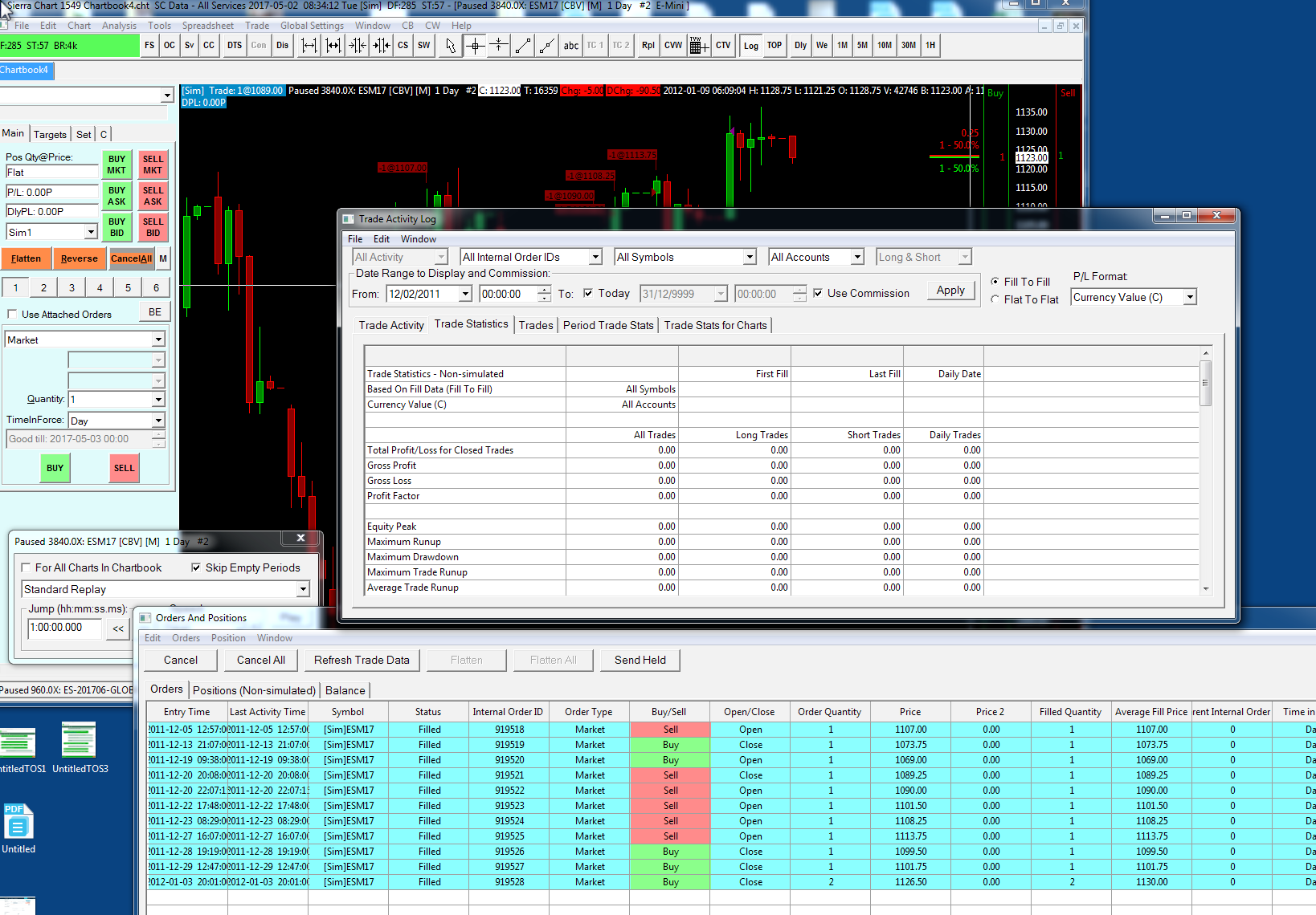

When I place trades, I can see a spreadsheet of the entry and exits, but I cannot see which trade made profit or loss.. all I see is a list of filled orders.
When I go to 'Trade Activity Log' I cannot see profit/loss for each trade. The cells are all 0.00.
Please see screenshot
Is it possible to view each pair of trades, i.e. open and close?
Thank-you

[2017-05-02 16:28:35]
Yes. Follow the instructions here:
http://www.sierrachart.com/index.php?page=doc/TradeActivityLog.php#TradesTabBasicInstructions
The problem is you did not select a simulated symbol in the list of symbols at the top of the Trade Activity Log.
[2017-05-03 07:42:02]
regikeyz - Posts: 4
Hi thank-you , yes it works now.. I did select 'All symbols' so you would have thought be very definition that included the symbol I was interested in.
Either way, it works now thanks.
[2017-05-03 16:45:12]
You need to read the documentation to understand that particular setting. That setting is clearly explained:
http://www.sierrachart.com/index.php?page=doc/TradeActivityLog.php#ViewingHistoricalTradeActivity
