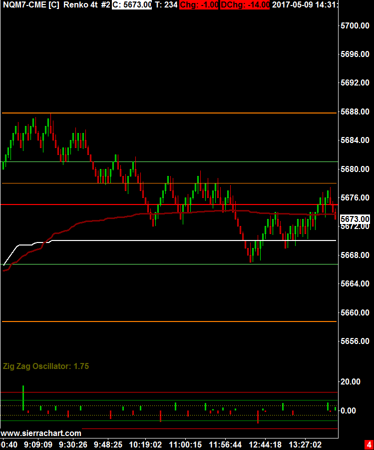

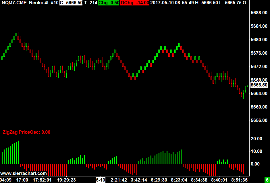

[2017-05-10 13:58:20]
User75949 - Posts: 142
set it up the zig zag oscillator as said on the instructions but it shows up like the one attatched showing only the reversal value instead it should show the zig zag value for each single bar.
THE SIERRA CHART OSCILLATOR AS IT SHOWS UP ON MY CHART
http://www.sierrachart.com/image.php?Image=1494424634294.png
ZIG ZAG OSCILLATOR AS IT SHOULD BE
http://www.sierrachart.com/image.php?Image=1494424549536.png
Let me know if it is just some wrong setting
regards

[2017-05-10 14:00:35]
the second oscillator (the right one) is from http://www.sawtoothtrade.com/free-stuff-8.html but with the problems I said above
Regards
[2017-05-11 03:42:24]
We apologize for this mistake. It will be corrected in the next release coming out in a couple of hours.

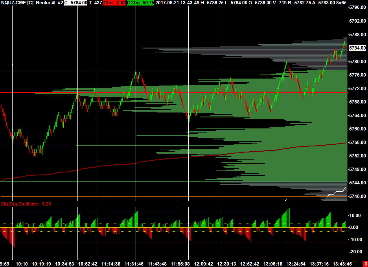

[2017-06-19 15:32:00]
I'm realizing that the new Zig Zag oscillator is not working properly.
As you see on the attached image the zig zag oscillator is not reflecting exactely what is happening, it should measure exactely the rotation of the zig zag indicator (it is setted exactely as the oscillator) I've put some vertical lines where it starts a new rotation on the other direction, the oscillator is not turning... it seems there is a sort of lag problem.... and on every rotation there is the same problem.
Please let me know
Regards
imagezig zag oscillator for support board.jpg / V - Attached On 2017-06-19 15:14:21 UTC - Size: 247.2 KB - 821 views
[2017-06-20 20:01:19]
Really the only logical conclusion is that there are different Input settings for those two different instances of the Zig Zag study. The Zig Zag study which is displaying the oscillator, needs to have identical settings as the main Zig Zag study in Chart Region 1.
Check them again. We cannot reproduce the issue.
[2017-06-21 19:55:58]
tks for the reply.
The point is not the settings that I assure you are exactely the same but the fact that the zig zag indicator is working fine and the oscillator is not.
I've canceled the zig zag indicator and now on the attached image you see only the oscillator, as you can see it doesn't work properly for 2 reason:
1) the vertical white lines show where a new rotation starts but as you can see the oscillator doesn't change the direction as it should it continues to go higher or lower I don't know for what reason
2) If I make the setting as you see, (calculation mode 3 and rotations for at least 3 ponts) the zig zag indicator works properly, showing only rotations bigger than 3 points but the oscillator, with the same settings shows also smaller rotations.
You can check by yourself also picking the same exact settings and make a zig zag indicator on region 1 and a zig zag oscillator on the region 2 you will see that they don't match.
Anyway the main issue is that the oscillator is not turning when it should.
To make easier calculation consider that every brick is a full point.
Please let me know
Regards

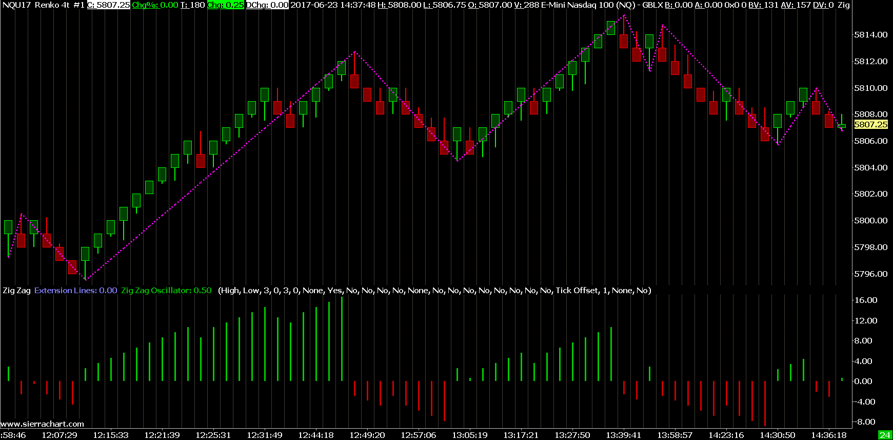

[2017-06-23 18:49:23]
Using the same Chart and Zigzag study settings you are, we do not observe an issue:
http://www.sierrachart.com/image.php?Image=1498243673640.png
This is testing on 1573 but the version you are running 1568 should be the same. There have been no changes to this study.
If you still see a problem you will need to provide us a Chartbook with one chart containing two instances of the Zig Zag study. One for the Zig Zag lines and one for the oscillator.
