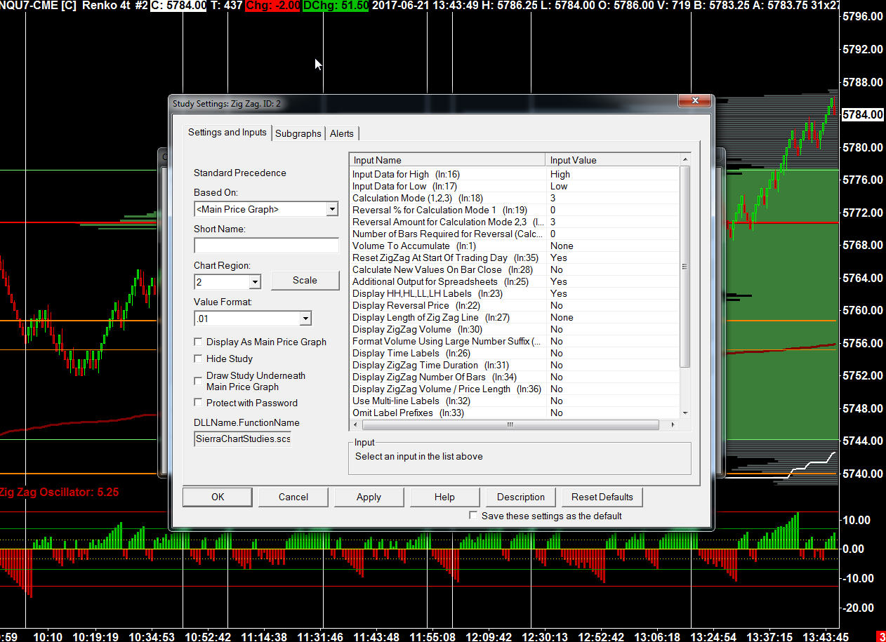

The point is not the settings that I assure you are exactely the same but the fact that the zig zag indicator is working fine and the oscillator is not.
I've canceled the zig zag indicator and now on the attached image you see only the oscillator, as you can see it doesn't work properly for 2 reason:
1) the vertical white lines show where a new rotation starts but as you can see the oscillator doesn't change the direction as it should it continues to go higher or lower I don't know for what reason
2) If I make the setting as you see, (calculation mode 3 and rotations for at least 3 ponts) the zig zag indicator works properly, showing only rotations bigger than 3 points but the oscillator, with the same settings shows also smaller rotations.
You can check by yourself also picking the same exact settings and make a zig zag indicator on region 1 and a zig zag oscillator on the region 2 you will see that they don't match.
Anyway the main issue is that the oscillator is not turning when it should.
To make easier calculation consider that every brick is a full point.
Please let me know
Regards
