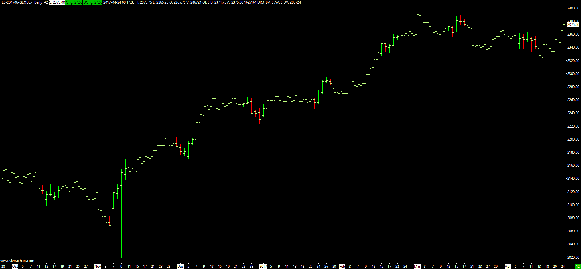

[2017-04-24 12:21:22]
SurfTrader - Posts: 88
http://www.sierrachart.com/image.php?Image=1493036252126.png
The CHT file Im referring to is a TPO chart, that is what Im trying to upload and expect to see. I successfully opened it last week, but did not save because I did not think I'd have an issue opening it again. Here is a screenshot, hopefully that can tell you what Im doing wrong, because I can not figure it out.
Ryan
[2017-04-24 12:27:28]
Looking at the screenshot now, what it does not show is this is the chartbook tab of cht file upload I tried, labeled dalton. The same one that is attached to my OP of this thread. Again Im not sure what I am not doing correctly to open the file correctly, that chart should be a TPO chart. Do I need to set up the TPO chart before I upload the cht file?
[2017-04-24 16:26:31]
It appears as though you did not open that particular Chartbook. We have opened it and updated the symbol to the Interactive Brokers symbol.
It is attached.
Follow the instructions here to use it:
http://www.sierrachart.com/index.php?page=doc/Chartbooks.html#UsingChartbookProvidedBySierraChartSupport
The answer to this is no:
attachmentJIM DALTON.cht - Attached On 2017-04-24 16:25:13 UTC - Size: 74.27 KB - 690 views
