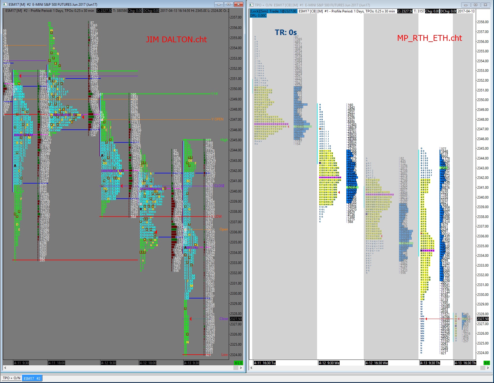

I was able to open and use your MP file, all I had to do was change the symbol to ESM17 as that's what my datafeed uses for the current S&P contract. I don't know what symbol your data providers uses for the current /ES contract.
Screenshot attached (with a side by side of your .CHT file the MP chartbook that I use), you may need to check your chart settings to make sure they're correct.
imageJim_Dalton_MP-MP_RTH_ETH.jpg / V - Attached On 2017-04-15 21:14:02 UTC - Size: 615.5 KB - 1753 views

Thanks for the response. Sorry, I am not familiar with SC at all. Where I can change the symbol to ES (Interactive Brokers symbol: ES-201706-GLOBEX)? When I right clicked on the Chartbook, there are no options available. However, if I create a new chartbook, I can right click and change the symbol. Maybe, I opened the chartbook incorrectly? Can you provide instructions on how to load/import an external cht file? I originally copied it into C:\SierraChart\Data folder but I am not sure if that is the correct approach. Any help is appreciated.

@User173602:
Thank you for your screenshot. I managed to enter the correct ES symbol and it is working now. Can you show me what configuration you made to display different colors for regular and extended trading hours sessions?
