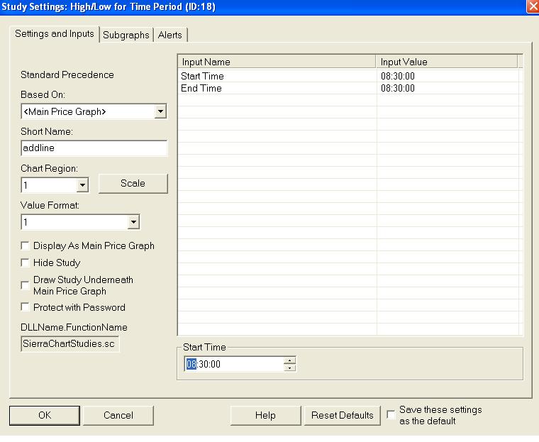

[2013-08-22 13:42:45]
mario mario - Posts: 22
I did not see study subgraph add/or menu here, is it somewhere else ?
imagefig1.JPG / V - Attached On 2013-08-22 13:41:37 UTC - Size: 63.3 KB - 830 views
[2013-08-22 20:10:09]
40winks : thanks it worked, I used a horizontal line as a base instead of ohlc bar, with high/low bar period, it was calculating based on high/low of the bar irrespective of the time period.
