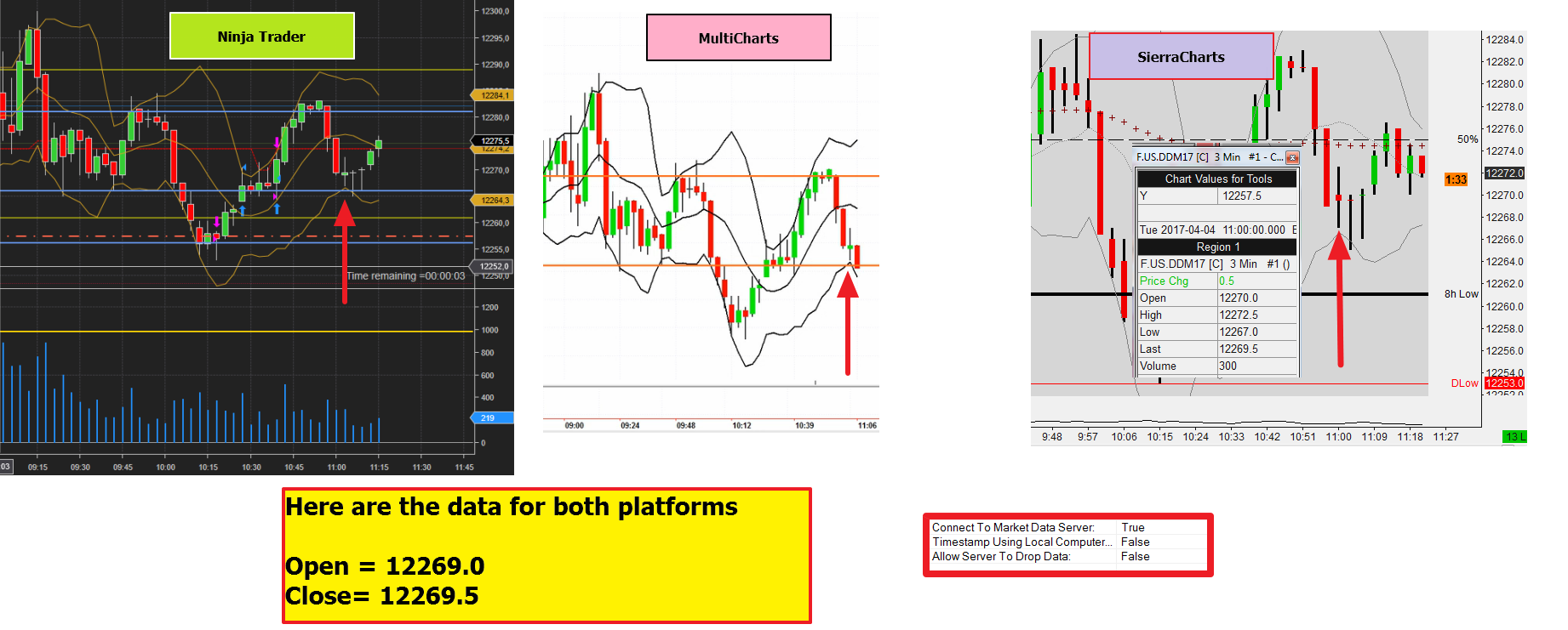

As you can see in the attached file there are three different platforms and all three are using the CQG Datafeed.
All charts are FDax from today with the TF of M3.
The problem is with the red arrow labeled candle ==>> SC = "red" and NT and MC are "green"
This is only an example but this is quite often - no matter what instrument - that the figure/ candle is different to NT or MC. NT and MC do have always the same figures/ candles. Only SC is different to other.
The same result is with the "VbP study" (only an example). Quite often the POC is different and in some cases also the VAH and VAL.
The timestamp option is set on "False"
I do not understand that result because all platforms are using the same datafeed.
What is the problem?

There could be a slight variance because we use our server time for time stamping the historical data.
We could switch to the CQG timestamps but we are just afraid of problems with those because we have seen that in the past.
We will switch to the CQG timestamp today and see how it goes.

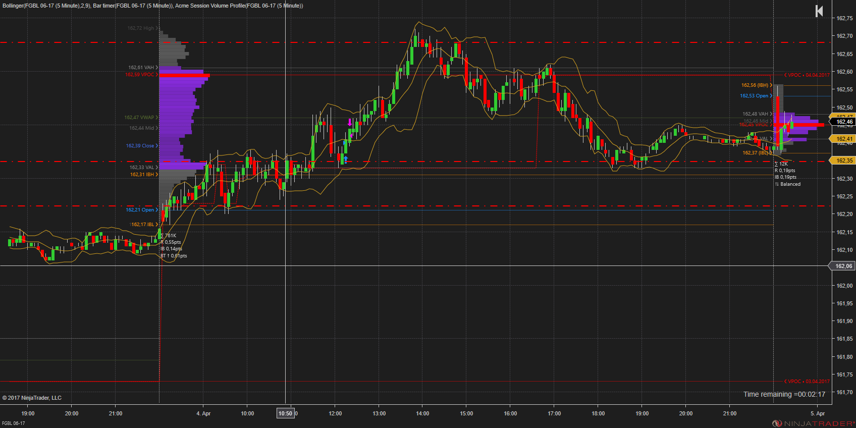

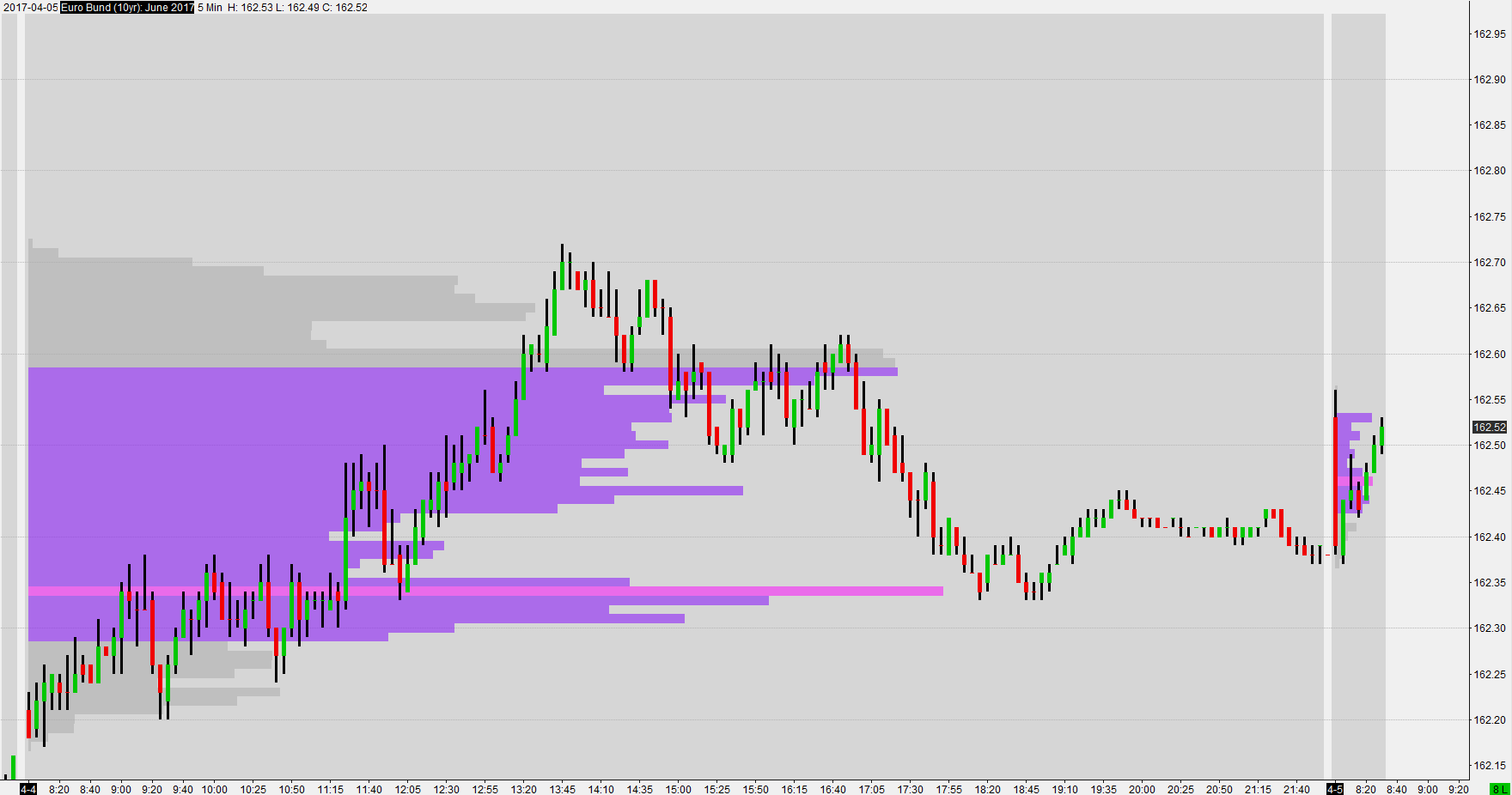

Here is a good current example in FGBL.
NT with CQG has it POC Yesterday on 162.59 and SC on 162.34. Therefore the VA is also different. I start SC two times but there was no change. This is really a big different if you work with that study
imageNT VbP 2017-04-05.png / V - Attached On 2017-04-05 06:36:48 UTC - Size: 125.25 KB - 318 views
imageSC VbP 2017-04-05.png / V - Attached On 2017-04-05 06:37:17 UTC - Size: 29.68 KB - 388 views

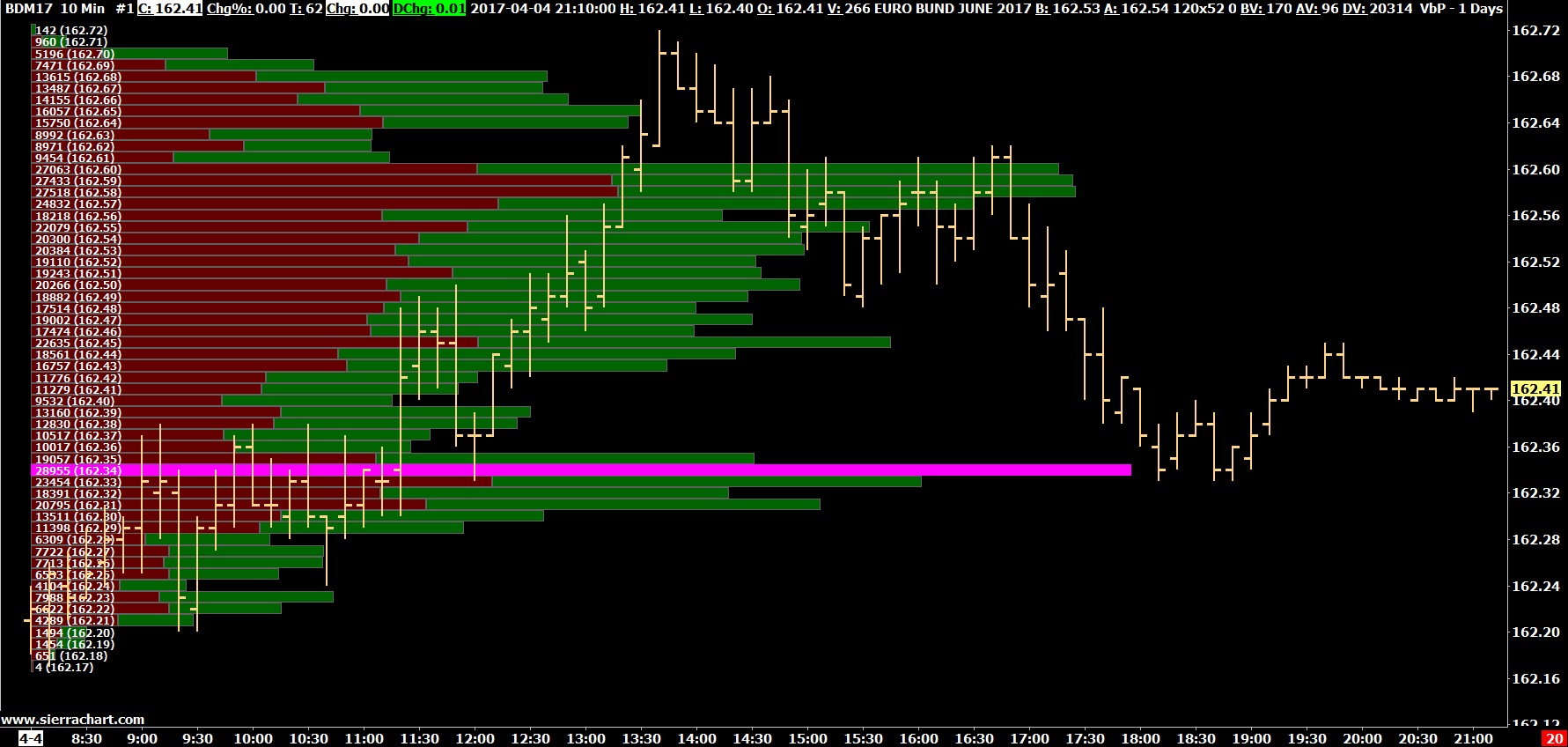

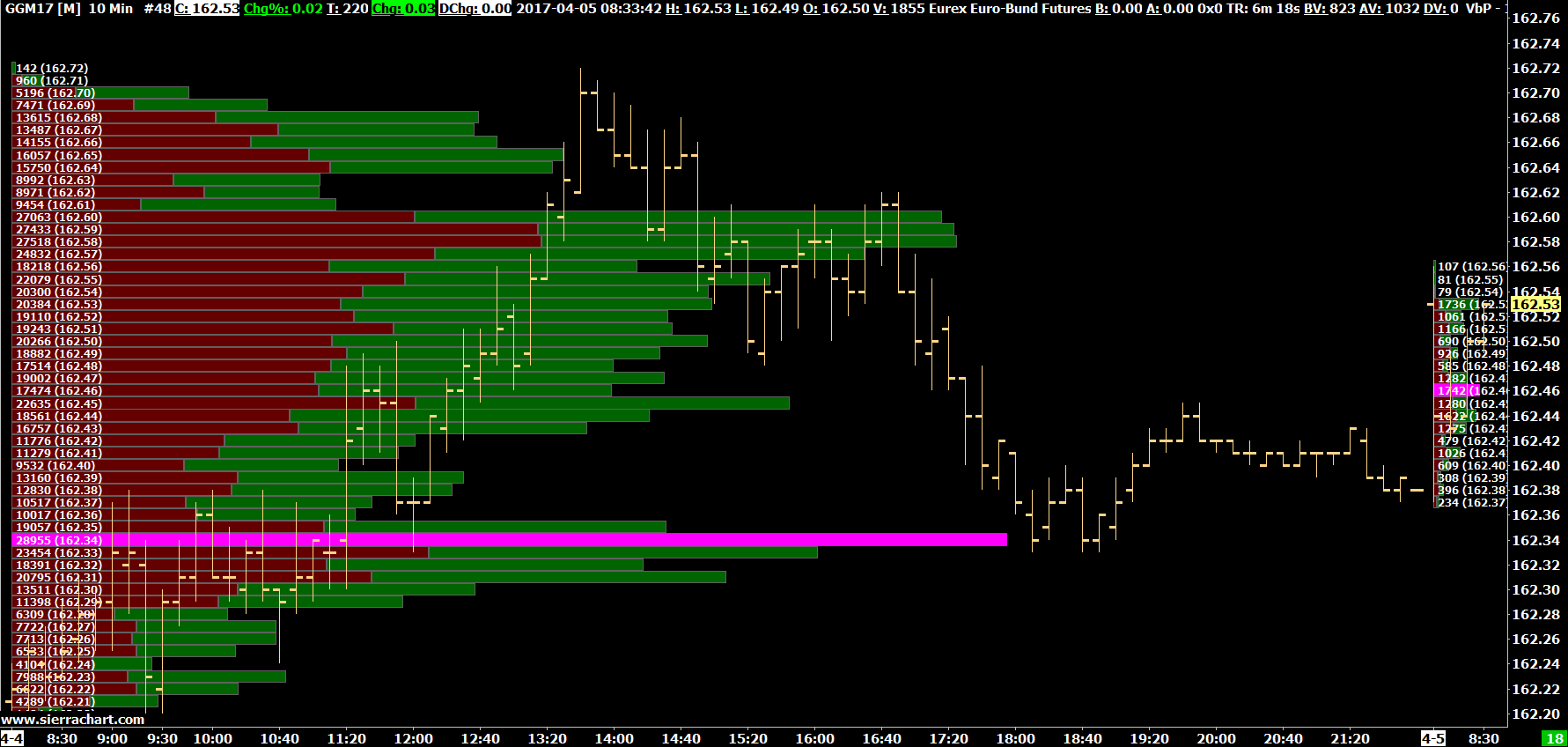

The point of control for the FGBL for 2017-04-04 is 162.34. We verified that from the Sierra Chart Exchange Data Feed data which is a very same data which has been reloaded into our CQG database.
Refer to:
http://www.sierrachart.com/image.php?Image=1491375064341.png
We have verified this with IQ feed:
http://www.sierrachart.com/image.php?Image=1491375448307.png
It does not matter how many times you start Sierra Chart. You just need to re-download the data following the instructions in help topic 2.1.2:
https://www.sierrachart.com/index.php?page=doc/helpdetails2.html#h2.1.2
So as you can see Ninja trader is wrong!!! Do you understand that?
