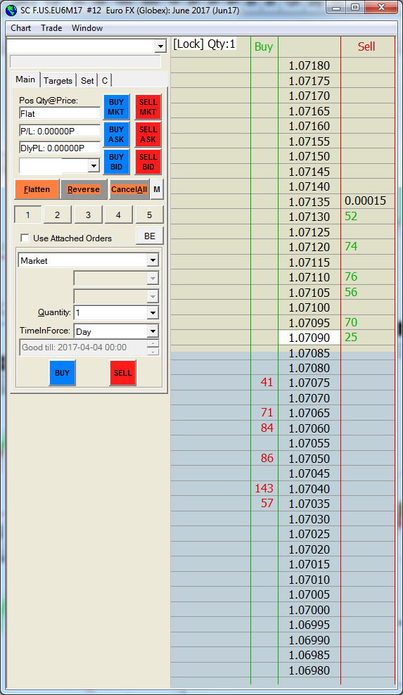

I have this strange DOM appearance ...even after clicking Reset.
Is that normal? Please see sizes displayed.
Thank you

The EuroFX contract trades in half-ticks (changed over a year ago). The DOM is in full-ticks. Thats why quantities seem to be between lines. I guess adjusting the symbol-settings or chart-settings of the DOM accordingly should fix this.

We think what they are pointing out is apparent missing levels.

AndyL - thanks for the idea. However if I still change settings to 5th decimal on the DOM and set tick size to 0.00005 it still shows strange. Please see attached.

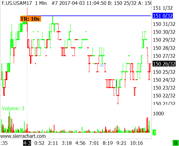

SC team, I am still having problems even after reconnecting as advised.
This is a new problem from today:
http://www.sierrachart.com/image.php?Image=149121033014.png
This chart is set to 1min but if you just look at time scale below, it doesn't make sense, not every minute is recorded.

Follow the instructions here to re-download the data for the last day and see if the missing data appears:
http://www.sierrachart.com/index.php?page=doc/HistoricalIntradayData.html#RetryDownloadDataInChart
After re-downloading the data, what you see definitely should then be correct.
