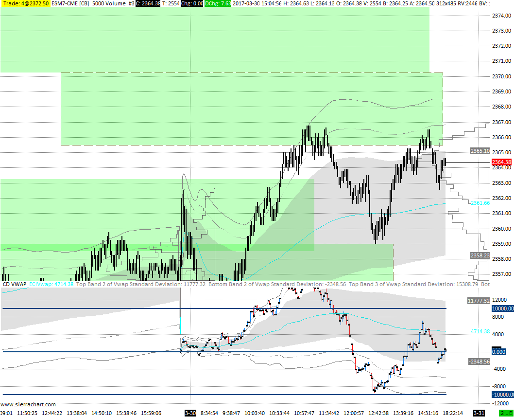

Every chart I have whether 15 minute, 5000 volume bars or TPO have the wrong price highlighted on the scale. This started happening only today. Example: instead of 6364.00 it says 2364.13 instead of 2363.25 it shows 2363.38 so it is adding 0.13 to every price. Please note the scale shows fine it is only the highlighted price that is wrong.

[2017-03-30 19:05:30]
SC - Posts: 9
I duplicated the chart. Removed all studies. reset scales. Same problem. Plus it isn't one chart it is ALL charts with ES. 30-min TPO charts, 5000 volume bar charts, 15-min time period candle charts everything.
http://www.sierrachart.com/image.php?Image=1490900697199.png

[2017-03-31 05:39:03]
SC - Posts: 9
This morning (01:38 EST) it has gone back to normal. Your suggestions didn't help but it has reverted on its own. Perhaps it was a data provider issue?
[2017-03-31 05:45:03]
That is the only logical conclusion at this point, but that would seem quite unusual.
However, perhaps it is the case.
Certainly it could not have been an issue with in Sierra Chart itself.
