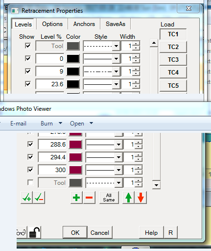

I can see two 'Tool' Level % in the list so that seems odd.
Please provide an image/screenshot of this.

[2017-03-26 21:58:43]
Trint - Posts: 115
See attached, I had to do two screenshots and merge them together as there are two many levels to do on one screenshot. One 'Tool' at the top of the levels and another at the bottom of the levels.

We want you to update to Prerelease 1534. We are putting this out in about 20 minutes.
After the update go to any of the Chart Drawing Tool configurations which are not correct (like Level % >> Tool in the wrong location) and then press the R button on the Tool Configuration window to reset them back to default. After that you can configure them as required.
[2017-03-27 13:54:03]
Trint - Posts: 115
Thanks...that Prerelease 1534 looks to have sorted the issue now. It also looks like I didn't need to reset the levels and re-add them from scratch as the prerelease worked out the box.
