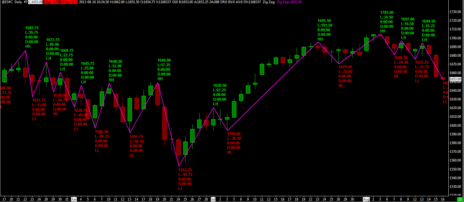

Please look at attached image. I am trying to plot # of days elapsed between the high and low swing of zigzag study. Even when the option is turned on, the study displays 0 value.
Let me know if I am missing anything here.
imageZigzag Study-Duration Issue.png / V - Attached On 2013-08-16 17:27:40 UTC - Size: 46.95 KB - 785 views
[2013-08-17 03:41:46]
Al SC Developer - Posts: 434
This will be addressed in ver 1013, when available.
