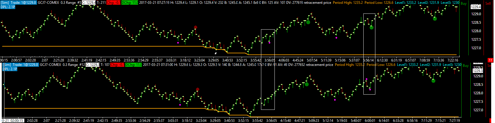

here the picture of the function "chart, duplicate chart" 3tick range chart bar whit my indicator
Do you have issue?

The real probleme I found it is on the candel in first rectangle.
Candel is not same and that cause trouble my indicator
In the second rectangle, that is my indicator I create and dont have opinion on that too.

OK we see now. We thought there might have been a difference with the candles but it was a little hard to tell because the charts were not lined up perfectly and the rectangles were partially covering the bars.
Go to each of those charts and select Chart >> Reload and Recalculate.
Do they then look the same?

I dont resolve it by Chart >> Reload and Recalculate
I try same time Chart >> Reload and Recalculate in speed less than normal and I see not difference too
I saw that on many chart I duplicate on Bar period Type : Range Per Bar-Standard (in ticks) "3" , some it is when market is too fast
Dont know if its same on other bar period type and really, I dont have opinion more than that but now you know

Therefore, there should not be any difference between the chart bars of two different charts if the settings are the same for both of them.
At this point, provide us the Chartbook file following these instructions here:
Tell us the Date-Time and time zone of one of the chart bars you notice is different. We just need to know one of them, this is all.
Also make sure Sierra Chart is set to a tick by tick data configuration:
http://www.sierrachart.com/index.php?page=doc/TickbyTickDataConfiguration.php

Hi, I just now found finally what was wrong,
On New Chart IN CHART SETTING >> ADVANCED SETTINGS >> CONTINUOUS CRONTRACT
was different of other chart so volume was not ajusted

We do not see how this is possible because we have verified that, that setting is copied when duplicating a chart.
