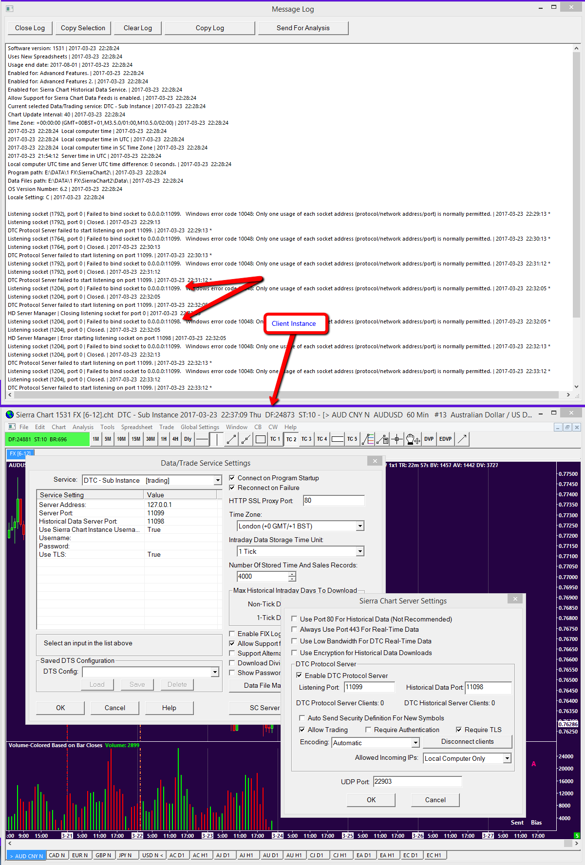

..however in the Message Log as you will see from the attached the listening port is not starting and I am unsure where to find the problem. I have attached 2 images of both my Server Instance and Client Instance, if you could kindly review my settings.
..I would be grateful if you could please advice where I might be going wrong, thankyou
..also so far I have 1 x Client Instance and hoping to add 2 more, can I do this by simply copying the same setup process for the subsequent 2,3 Client Instances as I did for the first?
Thanks and regards, Mark

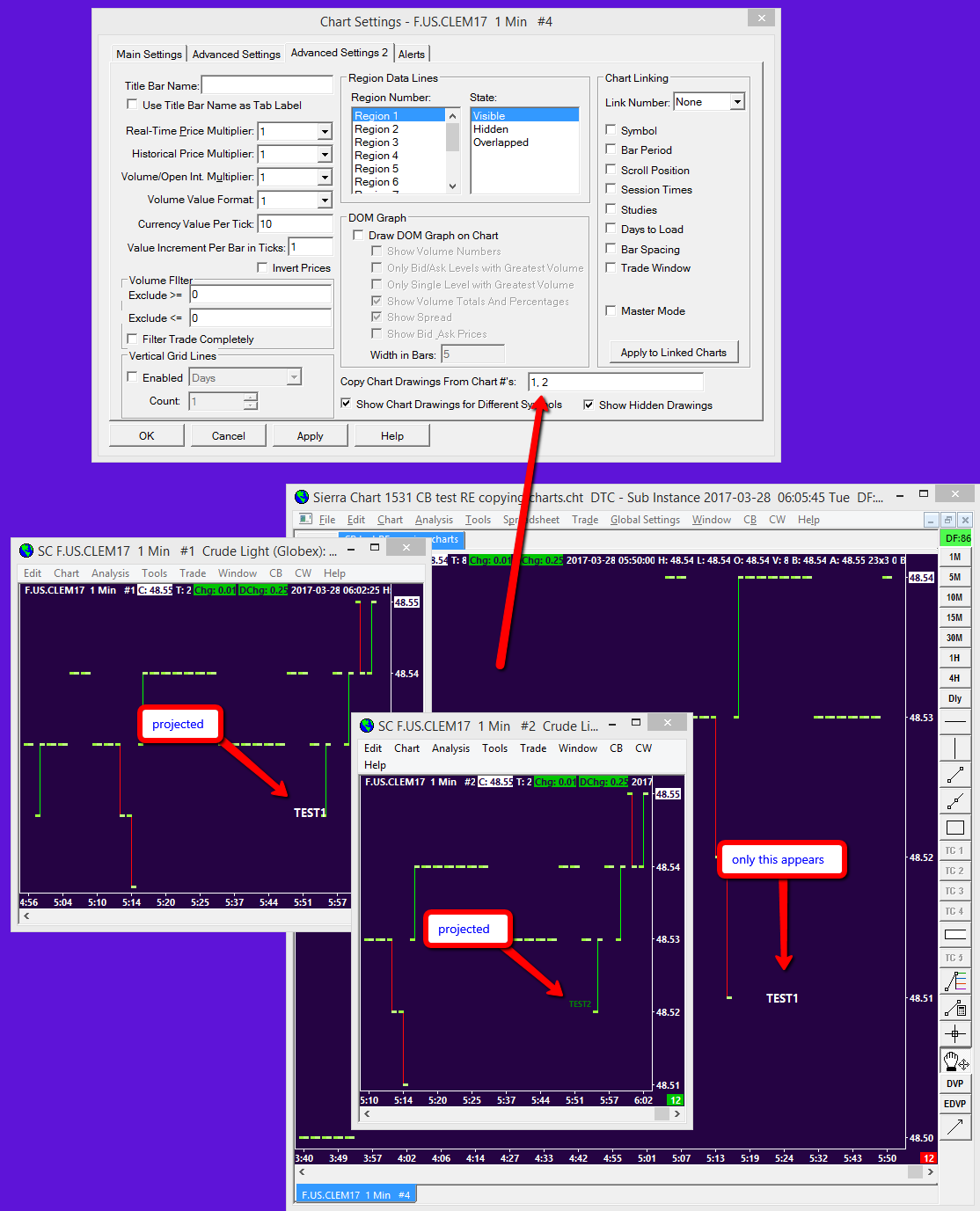

User78926 - Posts: 69
..sorry to ask yet another question, as you can see from the attached image I have a number of Chart Drawings copying through to the one Chart. This works fine on the Server Instance [shown in the image], however no matter what I try on any of the Client Instances only one other chart comes through instead of multi charts as expected. I can change chart numbers and they are copied individually, however never more than one Chart copy.
Wondering if it has something to do with Server / Client Instance relationship?
Many thanks, regards, Mark
Hi there, I seem to have resolved the 'listening port is not starting' conflict by disabling DTC Protocol Server on all the client copies.
However can you please attend to the previous [last] 2 questions re locations and chart copying? thanks :-)

Regarding post #13, we will need a Chartbook consisting of no more than three charts, which demonstrates this. Here are instructions to attach:

[2017-03-28 08:40:25]
Hi there, I have made up a Chartbook that demonstrates perfectly what the problem is. This chart has been made up in my second copy of SCs and only copies one copy of a chart despite 'requesting' 2 charts to copy. Please seen attached image that show what I mean.
Rgds, Mark
attachmentCB test RE copying charts.cht - Attached On 2017-03-28 08:35:48 UTC - Size: 64.84 KB - 417 views
imageCopy_Charts_example_1.png / V - Attached On 2017-03-28 08:40:19 UTC - Size: 123.89 KB - 518 views
[2017-03-29 04:54:50]
This is a problem that has recently developed. It will be corrected in the next release.

[2017-03-29 08:25:41]
..ok thanks, can you tell me when that might be so I can plan ahead?
[2017-03-29 10:18:41]
It is now available.
Date Time Of Last Edit: 2017-03-29 10:18:50
[2017-03-30 03:50:53]
..thanks it works perfectly now, appreciate it :-)
