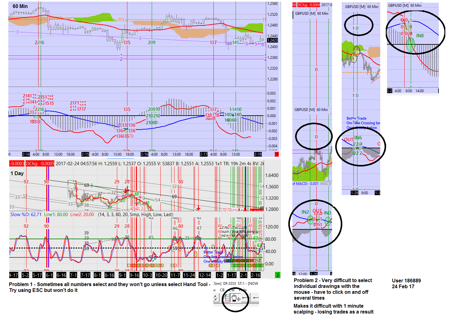

Hello Sierra
I really like your charts but for 2 items that really drive me bananas! Especially when I am trying to scalp a one minute chart (Screen shots attached)
PROBLEM 1 - Sometimes when I select one individual chart drawing or line, Multiple numbers appear on each drawing and can't be got rid of unless I select Hand Tool Feature (ESC won't work which is the obvious fix/action)
PROBLEM 2 - It is very difficult to select 2 drawings close together even if the mouse is carefully pointed at an individual drawing; I would estimate 25% of all my selections end up with multiple selections at the same time - why please? I could understand, like for example in Powerpoint, when you group objects you get multiple objects, but I am trying to select just one and getting many. This is quite frustrating on such a good tool. I have tried loads of different sensitivity settings and I can get it 'slightly better' but it still does it a lot of the time and really annoying when trying to do fast chart work like when scalping. I have attached a screen print of the 2 problems - Thanks Mark B
imageDrawing issue - Numbers and Sensitivity - 24 Feb 17.png / V - Attached On 2017-02-24 23:16:29 UTC - Size: 147.03 KB - 539 views

Here are a couple of tips that I use for these.
#1. If all the drawing numbers appear it may be because the Delete key was pressed. You can just right click anywhere on the chart with no drawing object and it returns to normal. If you click on a drawing object with a number it will be deleted.
If you click in an area with a cluster of drawing objects and numbers appear you can hit ESC or left click anywhere on the chart with no drawing object and it returns to normal.
#2. To select a drawing object in a cluster of drawings just press and hold the Alt key with the mouse click and it will cycle through the objects one at a time.
[2017-02-26 14:12:21]
User186889 - Posts: 55
To Canyon2
That was absolutely marvelous - and so simple as well
Thanks Mark B
Hello Sierra
See answer from Canyon 2; both his answers were wonderful and succinct and worked - but it would be useful if the ESC key could be used when all numbers appear on the screen to occult them, it's not obvious how to get rid of them.
As for being able to select objects when close together - I think some effort in looking at refining drawing manipulation would be welcome. It is not easy, for example -
(1) To select the objects without selecting many
(2) it's not easy to move objects as they often expand instead of move
(3) It would be useful to be able select multiple objects simultaneously if for example, you wanted to change all the colours at the same time - it would pay to see how Powerpoint do their shape manipulation and 'echo' the methods
Keep up the good work - Cheers -Mark

We have updated the documentation here regarding Converging Drawings:
Chart Drawing Tools: Converging Drawings
The Escape key does cancel the identification numbers when there are multiple drawings which have been selected when you left click in an area where there are converging drawings. If this is not working for you describe the steps so we can reproduce.
In this particular case, use this method documented here:
Chart Drawing Tools: Move Drawing - Menu and Control Bar Button Method (Menu and Control Bar Button Method)
Use the method explained above or make sure you left click near the middle of the drawing.
Date Time Of Last Edit: 2017-03-01 09:10:19
