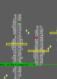

is it possible to have an alert, when using number bars with diagonal compares?
Id' like to have an alert when a bar closes which has atleast one column with a highlighted bid/ask value (green/red).
Please habe a look at the attached screenshot.
Thx!

[2017-02-24 18:10:15]
Use the Volume at Price Threshold Alert V2 study:
https://www.sierrachart.com/index.php?page=doc/StudiesReference.php&ID=386#Volume_At_Price_Threshold_Alert_V2
You will also need to update Sierra Chart to the latest version. Follow through the instructions here:
https://www.sierrachart.com/index.php?page=doc/download.php#FastUpdate

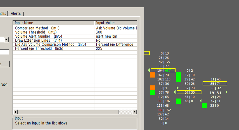

pappe88 - Posts: 22
That looks good!
But unfortunately the volume threshold seems to not work when using precentage difference. So I get almost every new bar an alert.
Please see attached my settings and my chart. As you can see I have to much threshold alert v2 squares :(
On the number bars I work with a Bid/ask minimum Volume compare threshold of 90.
Is there a way to use the volume threshold with percentage difference method?
imageBildschirmfoto vom 2017-02-24 20-58-59.png / V - Attached On 2017-02-24 20:00:00 UTC - Size: 43.26 KB - 678 views

How is the Comparison Method input set? We cannot fully tell.
Also update Sierra Chart to the latest release.
