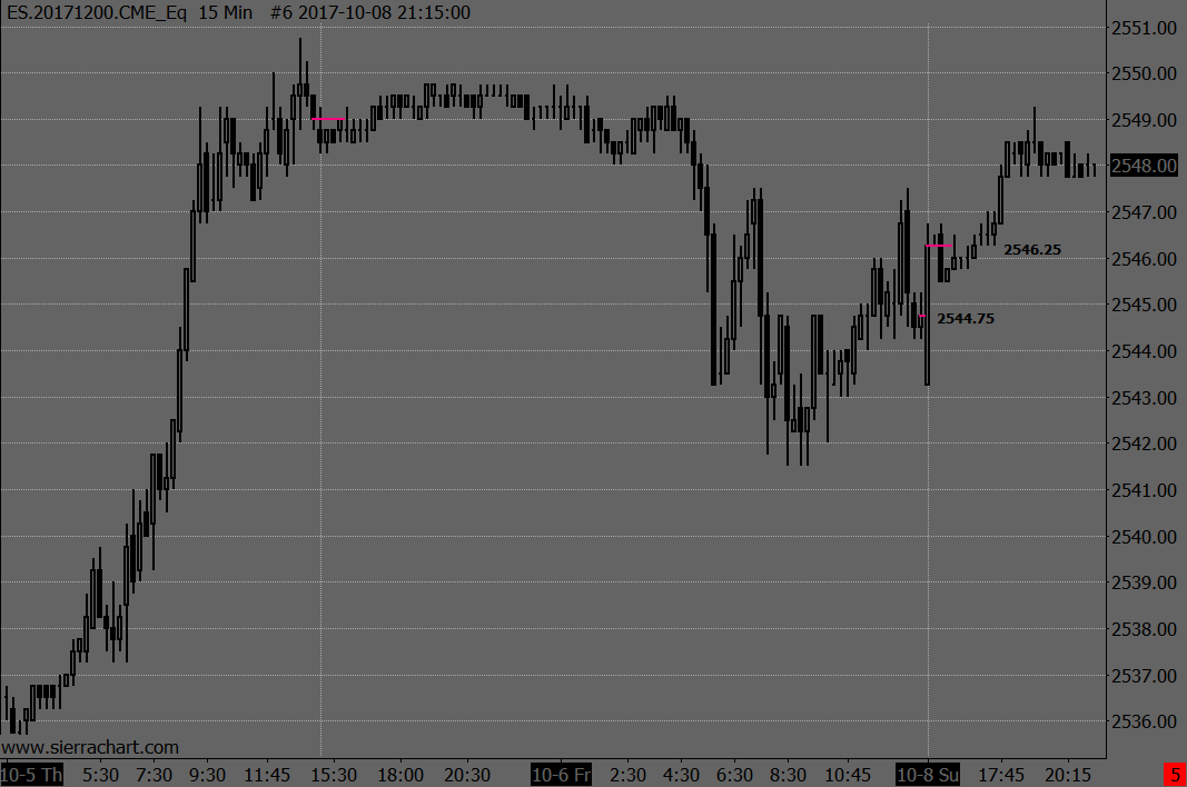

This is what we see with the configuration you describe:
http://www.sierrachart.com/image.php?Image=1507716011403.png
We do not see anything unexpected.

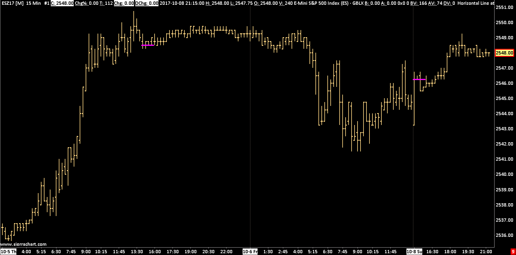

[2017-10-11 13:13:14]
User727245 - Posts: 29
We are not on the same page here.
Your study is indicating the last traded price of the first bar of each session.
I was talking about the last traded price of the last bar of each session.

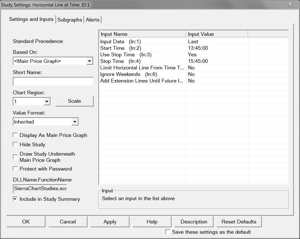

For ES, if you used the setting shown in the attached image, you'd see this as I initially described:
http://www.sierrachart.com/image.php?Image=1507726981855.png
My chart has exactly the same number of bars as the one you posted.
As you can see, the last traded price for 10/6 Friday is 2544.75
The line stops extending when Sunday opens, and it draws a new line
from the last traded price of the first bar of the session at 2546.25
The line for the last trade price of 10/5 Thu is working as it should per the setting.
imagestudy setting.JPG / V - Attached On 2017-10-11 13:01:29 UTC - Size: 111.06 KB - 481 views
