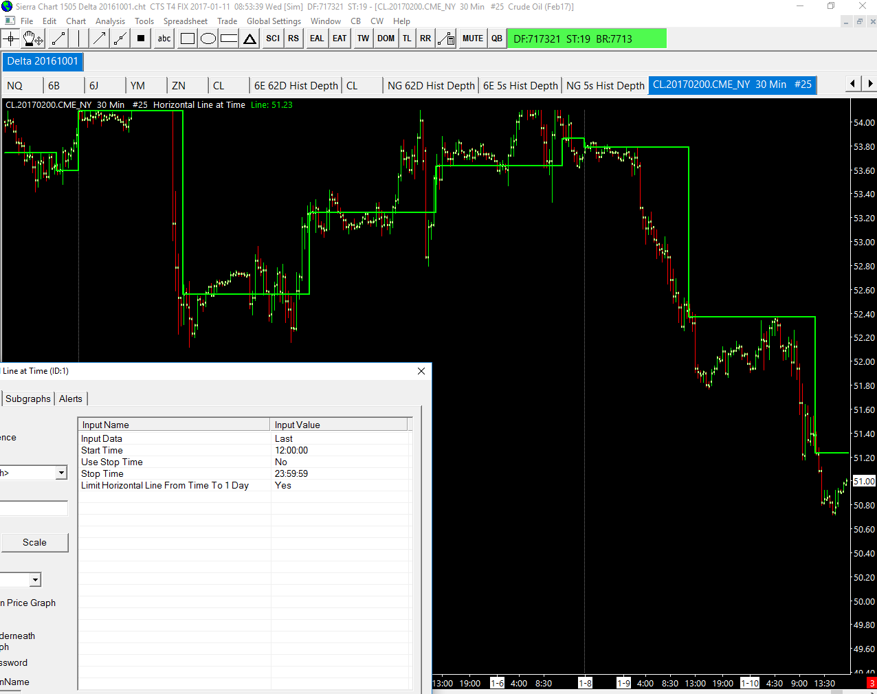

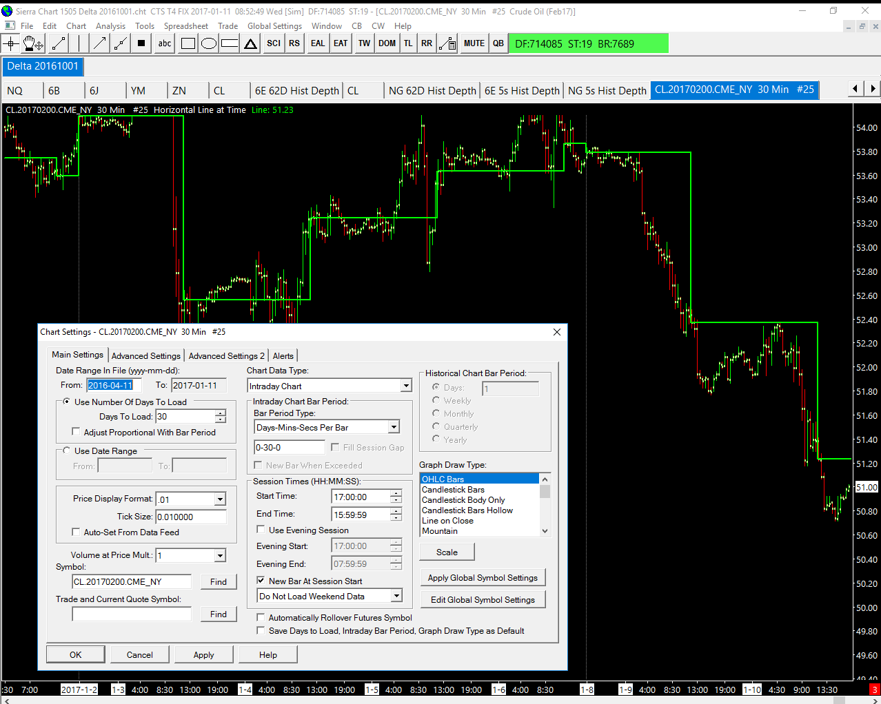

The error occurs with default study settings.
I have tried switching things around as you suggested:
the study works correctly if I change "Chart Settings / Session Times / Start Time" to "00:00:00" and "Do Not load Weekend Data".
Unfortunately that is not much use to me because futures markets start every session at 17:00:00 CT and I use other studies depending on the session time.
imageClipboard02.png / V - Attached On 2017-01-11 14:56:45 UTC - Size: 53.36 KB - 499 views
imageClipboard01.png / V - Attached On 2017-01-11 14:56:52 UTC - Size: 84.42 KB - 515 views

OK, but as we said there are no changes planned. We would not make any changes for the reason given.
And it takes a significant amount of time to even analyze this anyway and we would probably conclude there is nothing wrong according to its design.
