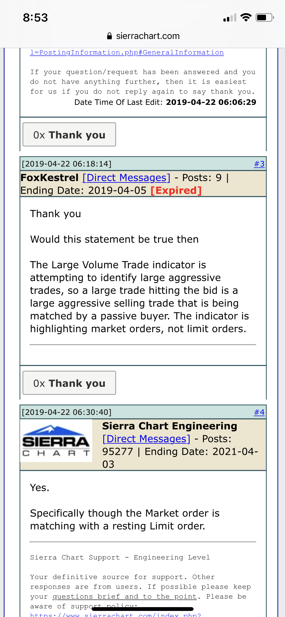

You have not touched my simple question . I am subscriber of Sierra chart . Your reply in 2 posts are contradictory to what your own administrator accepted that “ it is market order hitting the resting bid or offer “ but you are closing the topic without replying to my color specific question .
The description is totally misleading and not conveying exact essence .
