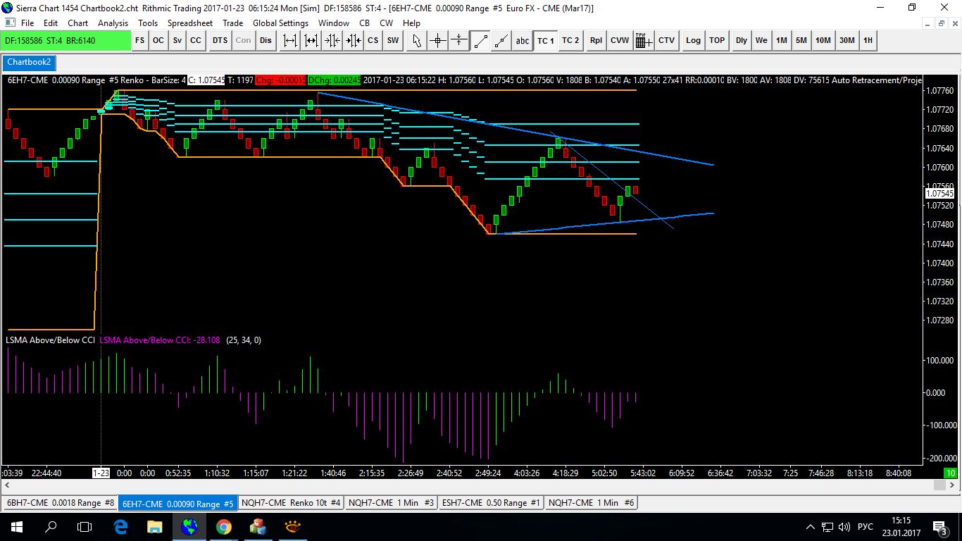

Hello. The problem is this: not a valid building Renko graph in realtime.
The bottom line: if you include Renko chart at the moment it displays the correct story but if you do nothing with the schedule nachinaetsya not displayed correctly.
There is a real map and historical. How to do so would in the real construction of the Renko chart
Screenshots will be in session. At the moment, you can see historical quotes unchanged
imageБуфер обмена-1.jpg / V - Attached On 2017-01-23 10:12:42 UTC - Size: 146.13 KB - 410 views

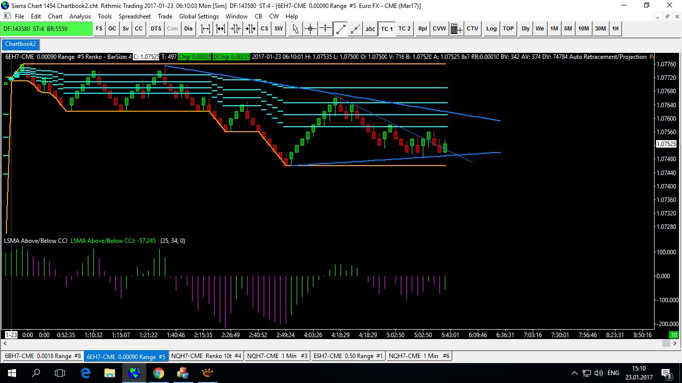

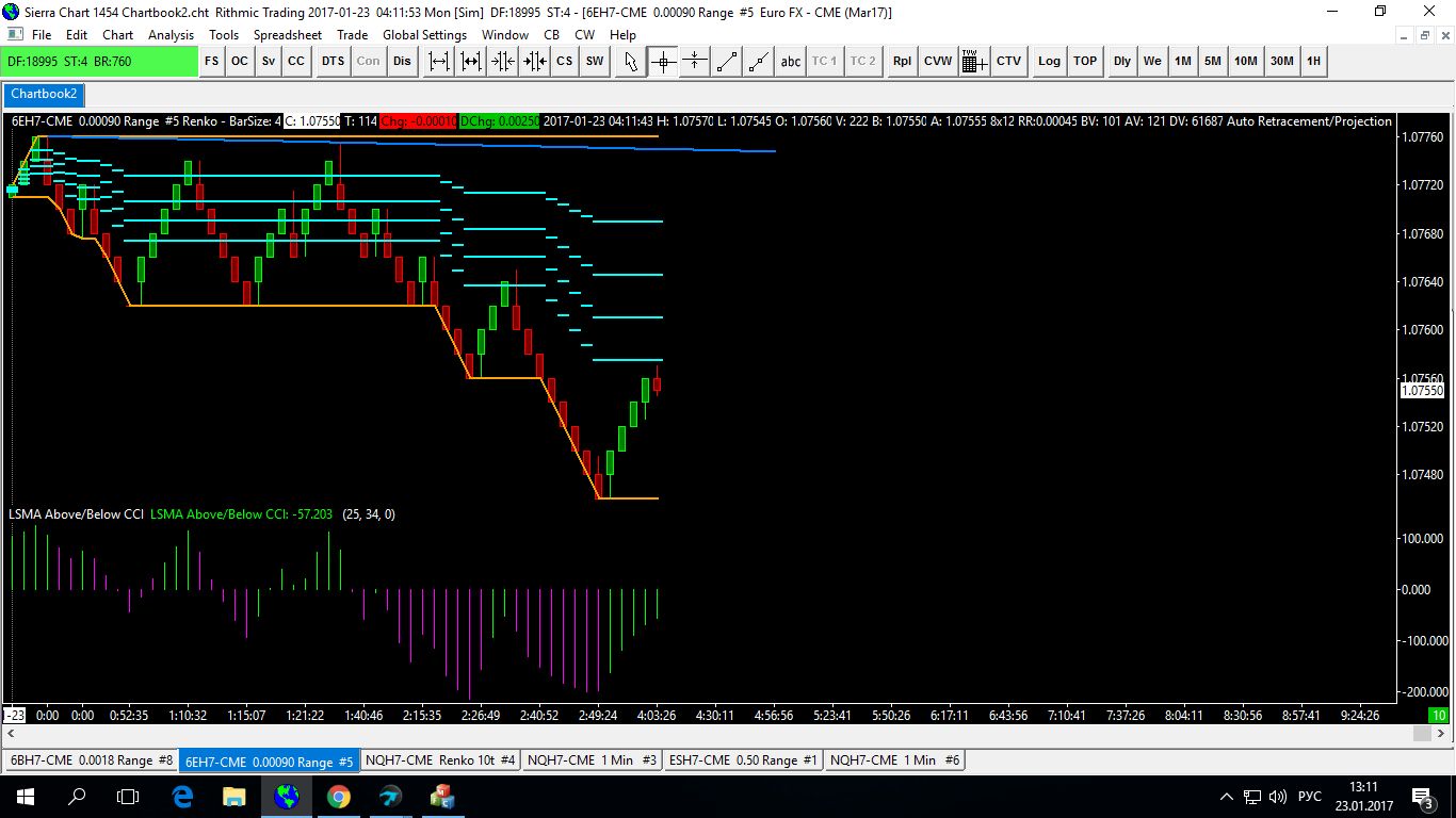

Here is an example: in the screenshot 1, we see realtime quotes Renko at the moment. I did not add anything not clean up the schedule so hanging over hours.
But as soon as I start to make some kind of action to the schedule (cashing F5 to refresh generally do something) Renko schedule changes. I do not understand why, and why it depends. Maybe you can help me
imageБуфер обмена-1.jpg / V - Attached On 2017-01-23 12:12:55 UTC - Size: 160.94 KB - 412 views
imageБуфер обмена-2.jpg / V - Attached On 2017-01-23 12:13:31 UTC - Size: 211.55 KB - 398 views
imageБуфер обмена-3.jpg / V - Attached On 2017-01-23 12:15:42 UTC - Size: 159.45 KB - 493 views
[2017-01-23 18:18:29]
Do not use any of the Renko studies. Remove all of those from the chart. Only use the Renko Bar setting in Chart Settings. Here are instructions:
http://www.sierrachart.com/index.php?page=doc/RenkoCharts.html
