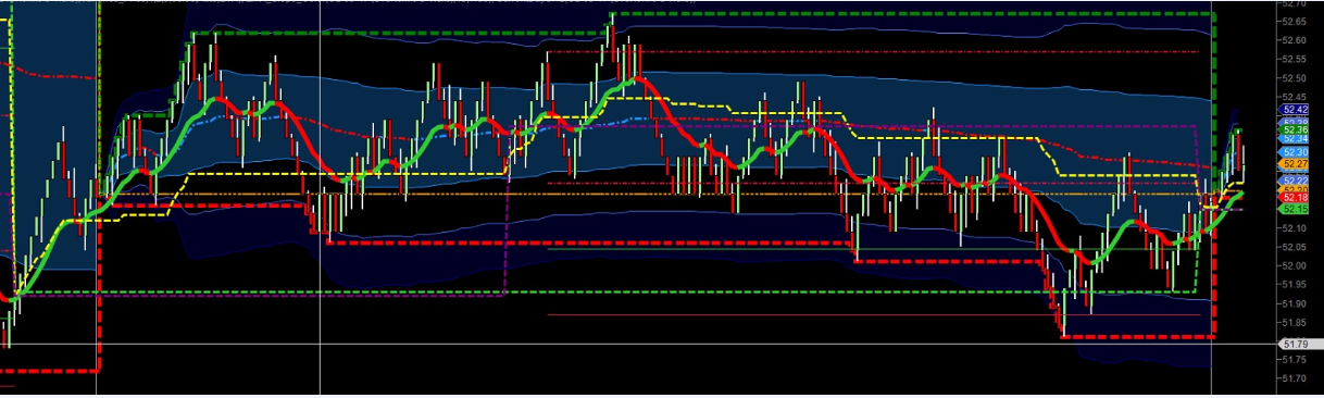

I'm trying to replicate an indicator which plots the highest point in a developing chart and then tracks that point forward until a new high is made. This wasn't possible using the highest high / lowest low.
I have attached a picture of the indicator i'm trying to replicate. It is the Top Green dashed bar. You can see it plots the highest point then continues at that point until a new high is reached.
Any advice would be appreciated.
imageHigh_Plot.png / V - Attached On 2017-01-20 19:13:04 UTC - Size: 516.62 KB - 386 views

Yes you can do this with the Daily OHLC study:
https://www.sierrachart.com/index.php?page=doc/TechnicalStudiesReference.html#s137
Specifically refer to this section:
https://www.sierrachart.com/index.php?page=doc/TechnicalStudiesReference.html#DailyOHLC_DisplayingTheHighAndLowLinesIncrementallyForDay
You can hide any Subgraphs you do not want to display.
