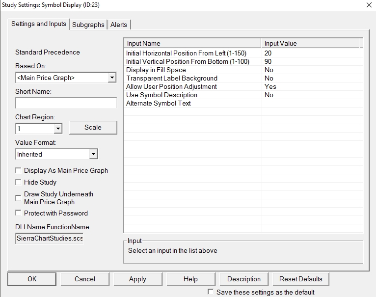

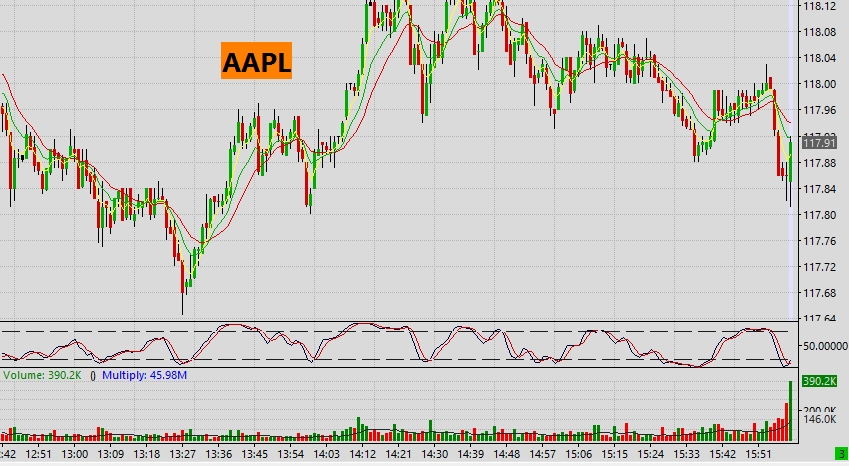

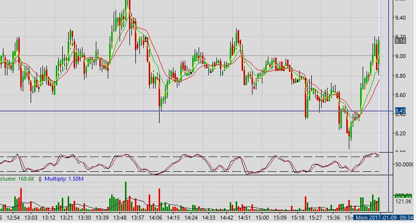

Kinobe - Posts: 86
here is 3 pictures showing the problem
I inserted the study with aapl
I changed to anther symbol and the display disapears
I changed nothing in the seetting - see picture.

[2017-01-20 02:36:34]
Kinobe - Posts: 86
I found that If I checked the case "Show chart drawings for differents symbols"
the symbol name remains displayed when I change the stock
...but I have as well all lines of all stocks I drwaned before... :-(
could it be possible to get the symbol display without having all line of differents stock?
[2017-01-20 03:18:11]
OK we understand the reason for the problem now. This will be solved in the next release.
