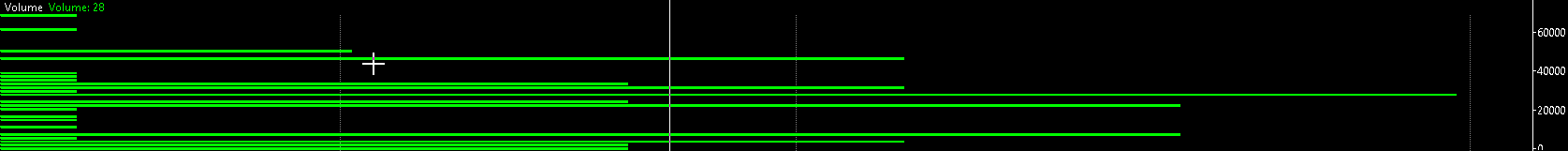

I tried to change a volume histogram to show show as Horizontal Profile subgraph instead of Bar subgraph. I need to know for example what is the mode and value area for the distribution. How can I get VPOC, VAL, VAH plotted please? And could this data be exported?
I am attaching an example. This volume profile doesn't seem correct to me. How can I change the Bin on the y Axis if for example i want a histogram grouped for every 100 volume.
The histogram seems to be set to display according to what is visible on the screen. How can I control on which data the horizontal profile is calculated. Say I only want a profile drawn based on the last 5 days only.
Thank you
Date Time Of Last Edit: 2017-03-16 21:39:43
imagehorizontal profile.png / V - Attached On 2017-03-16 21:33:08 UTC - Size: 3.82 KB - 568 views
[2017-03-17 04:24:20]
None of what you are looking for is supported with that Draw Style and we cannot provide further with this. This is totally and completely outside of the capabilities of that Draw Style. You are going to go nowhere with these requests.
