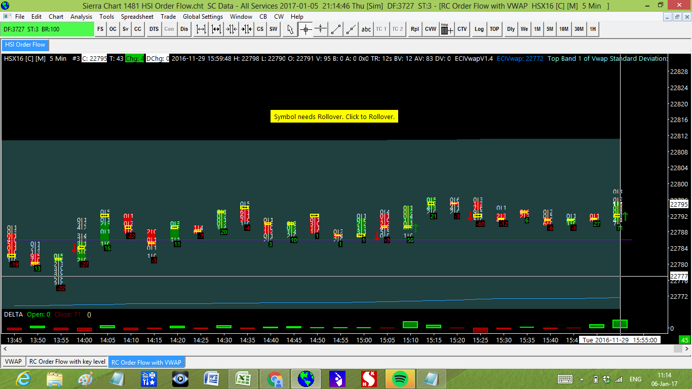

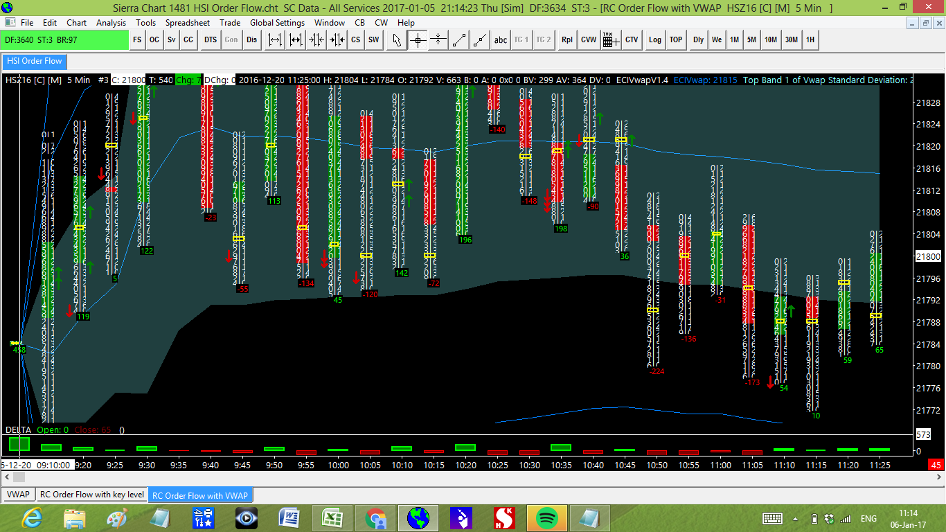

I need to go back to some historic data on one of your charts, HSI Order Flow, but can't retrieve the ones from 10 Dec 2016 to 19 Dec 2016. In particular, I need the page rdg RC Order Flow with VWAP.
I have attached screencaps of the month Nov and Dec. I can only see data on the Nov chart for data til 29 Nov; and data on the Dec chart for data starting from 20 Dec. I need those from 10-19 Dec.

[2017-01-06 05:17:08]
The best thing to do is to use the Continuous Futures Contract feature:
Continuous Futures Contract Charts
We can see you are using this feature, but you need to make sure the chart is set to the current contract month which is January.
You may also want to use Volume Based Rollover.
If there is any missing data, refer to:
https://www.sierrachart.com/index.php?page=doc/ContinuousFuturesContractCharts.html#ReDownloading
