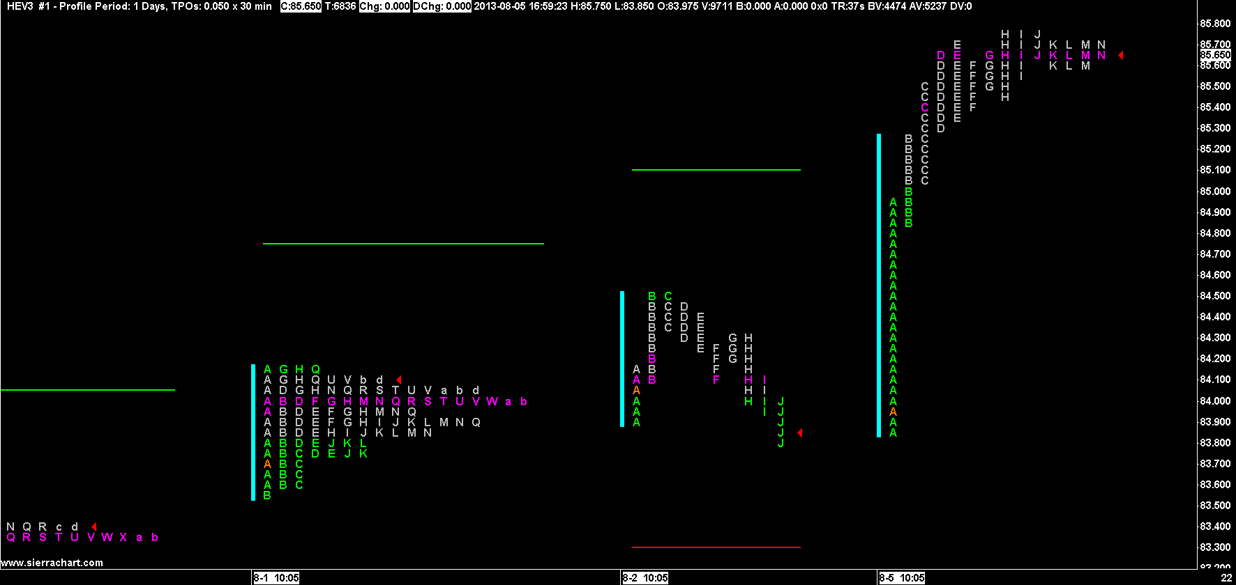

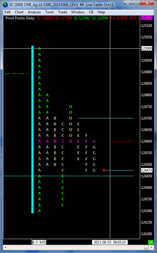

I updated sierra charts and after that all my market profile charts are not working.
I trade hogs and cattles and my profile start period is 09:05 chicago time, and the first half hour is until 09:30. Not i have the "A" column.. I attached an imagine!!!
Please let me know how to change the set up.
I tryed to instal the old version, but I have the same problem
In chart setting If i put 09:00 the profile is ok, but for me is not good because i need the pit opening time and value!!!

Can you provide us your Chartbook that contains this chart. Follow these instructions:
https://www.sierrachart.com/index.php?l=PostingInformation.php#AttachFile
And let us know what your Time Zone setting in Sierra Chart is.
[2013-08-06 19:45:31]
For us, the chart looks good:
http://www.sierrachart.com/image.php?l=137581831164.png
We will have to get your Chartbook to see your settings.

I attached you the set up I use, there are more charts but i think you can find the hogs and cattles, the 2 i have problem with
Greg

We have an idea of what the problem is. This has been resolved in the latest prerelease. However, before you update, we need to do some additional work on the connection to CTS because it uses a new FIX connection. We should have a new release out later today.
[2013-08-10 02:02:07]
Thank you for your patience and we do apologize for the issue. We are now ready with all of the necessary changes for CTS FIX. The particular TPO Profile Chart problem you describe is also resolved. Please update Sierra Chart to the latest release by selecting Help >> Download Prerelease.
You will need to follow through the documentation here to use this new version:
http://www.sierrachart.com/index.php?l=doc/CTS_T4.php#UsingFIX
You will need to change the symbols of the charts as explained. After changing the symbols, we recommend saving your Chartbooks under a different name by selecting File >> Save As for each Chartbook. This is because if you need to go back to a prior version, then you will have a Chartbook with the original name using the prior symbol format.
If you have any difficulties, please let us know when and we will help you with them.

Hi I has this problem now.. I think some spread are not charging!!!
[2013-08-12 11:58:45]
User80764 - Posts: 10
Ok as i see i can not charge Spread Charts, I can not find them in CTS symbols.. If i click "get additional symbols" no spread symbols as before!!!!
Please let me know what should i Do!!!
greg

One problem is you did not update to the latest prerelease. You are running one version earlier. You needed to update by using:
You also needed to update the symbols of the charts. We had provided you the link to the CTS T4 page for instructions but did not give the correct subsection:
Anyway, some of the symbols you need are missing for the new connection type. We are working on that. For now please go back to the prior version using this link:
http://www.sierrachart.com/downloads/997SierraChartSetup.exe
To open Chartbooks, you may need to use backup Chartbooks if you saved the Chartbooks under the new version. Here are instructions for that:
http://www.sierrachart.com/index.php?l=doc/doc_Chartbooks.html#BackupChartbook
Date Time Of Last Edit: 2013-08-12 16:45:24

We have updated the CTS FIX symbol lists in Sierra Chart. The missing NYMEX contracts have been added and the ICE contracts. For any futures market you will also be able to use Get Additional Symbols to get all of the spreads.
We recommend updating when you do not have an urgent need to use Sierra Chart so you have some time to update the symbols.
At that time, update by using Help >> Download Prerelease.
You will need to follow these instructions to change the symbols of the charts:

We see you are running an older version of Sierra Chart. The TPO chart problem you have described was resolved more than a month ago.
You need to update Sierra Chart by following the instructions in post #10. Here are the instructions:

The problem with the particular spread symbols you are using was resolved within five hours of your post on August 12.
