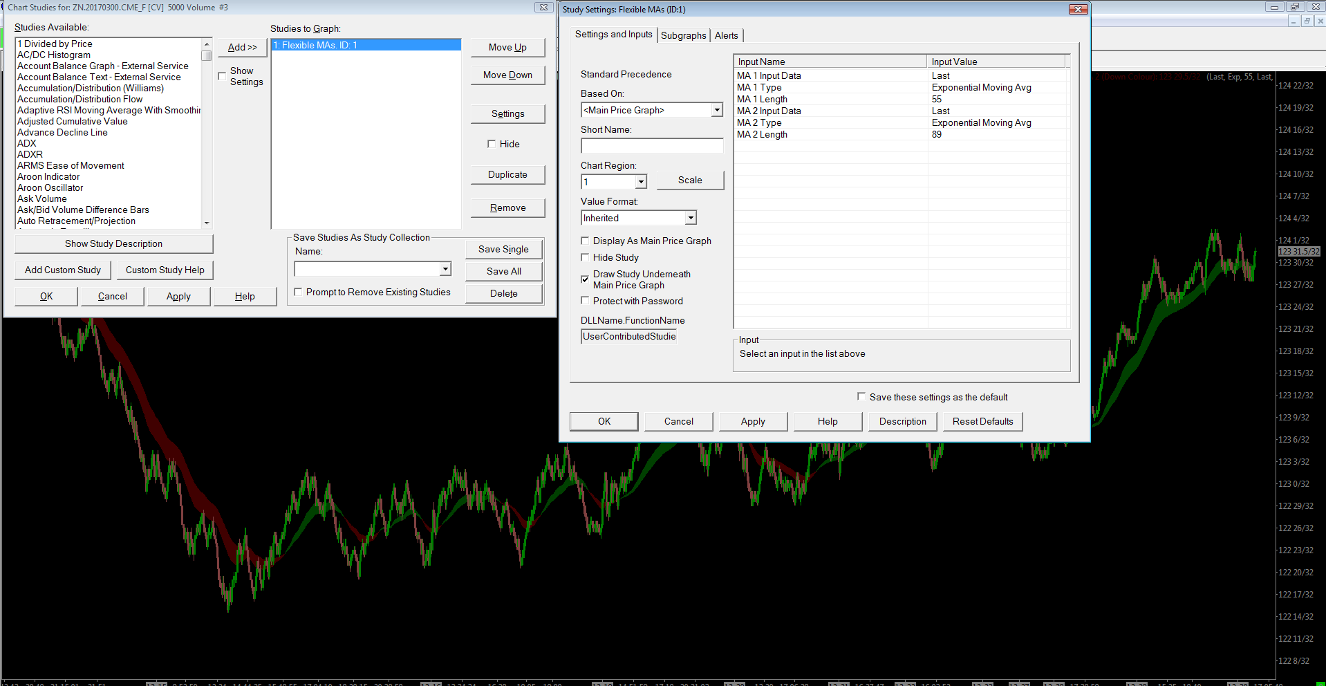

You have already bulit in study for that FlexMA

User84094 - Posts: 58
User Contributed Studies
Flexible MAs
image1.png / V - Attached On 2016-12-30 12:26:02 UTC - Size: 158.63 KB - 656 views
