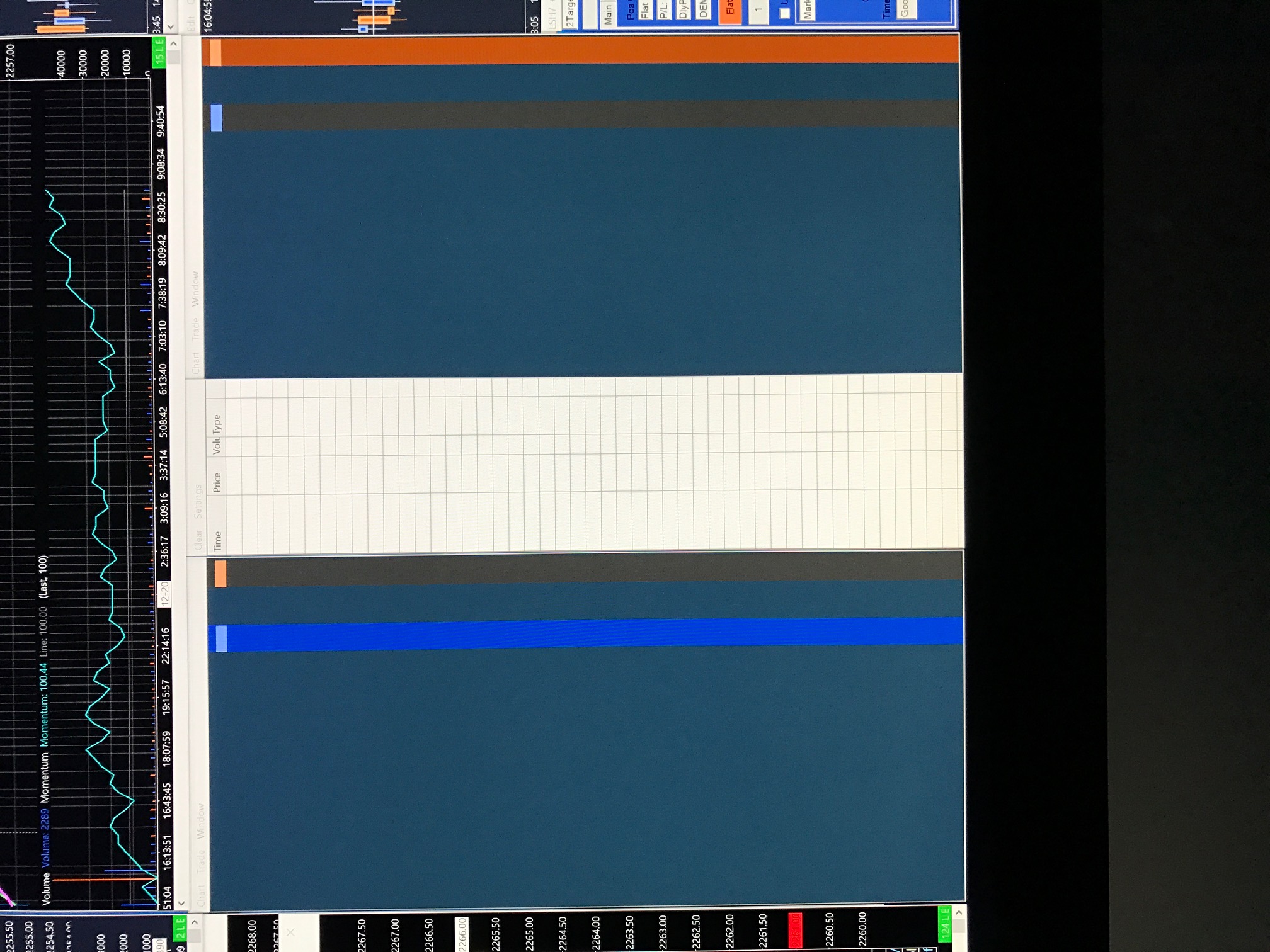

My DOMs are not loading again. I closed the chartbook and reopened it. Also I switched to a different symbol and some load, some don't. But ESH7 is not loading at all, my DOMs are blank. For the DOMs I Reloaded and Recalculated Data-- to no effect. I also Deleted All Data and Downloaded for the whole chartbook, and the DOMs remain blank. I am stuck.
Looking to trade this morning. Any advice would be appreciated. Thank you

[2016-12-20 14:49:14]
Dmac - Posts: 25
The issue resolved itself. My chart settings were set to session time start 9:30 EST. At that exact time, the DOMs populated. I set the charts for 9:30 to confine my VbP study to RTHs. But usually the DOMs load fine with current RT data and then the volume only resets at 9:30. Today the DOM itself remained blank until 9:30

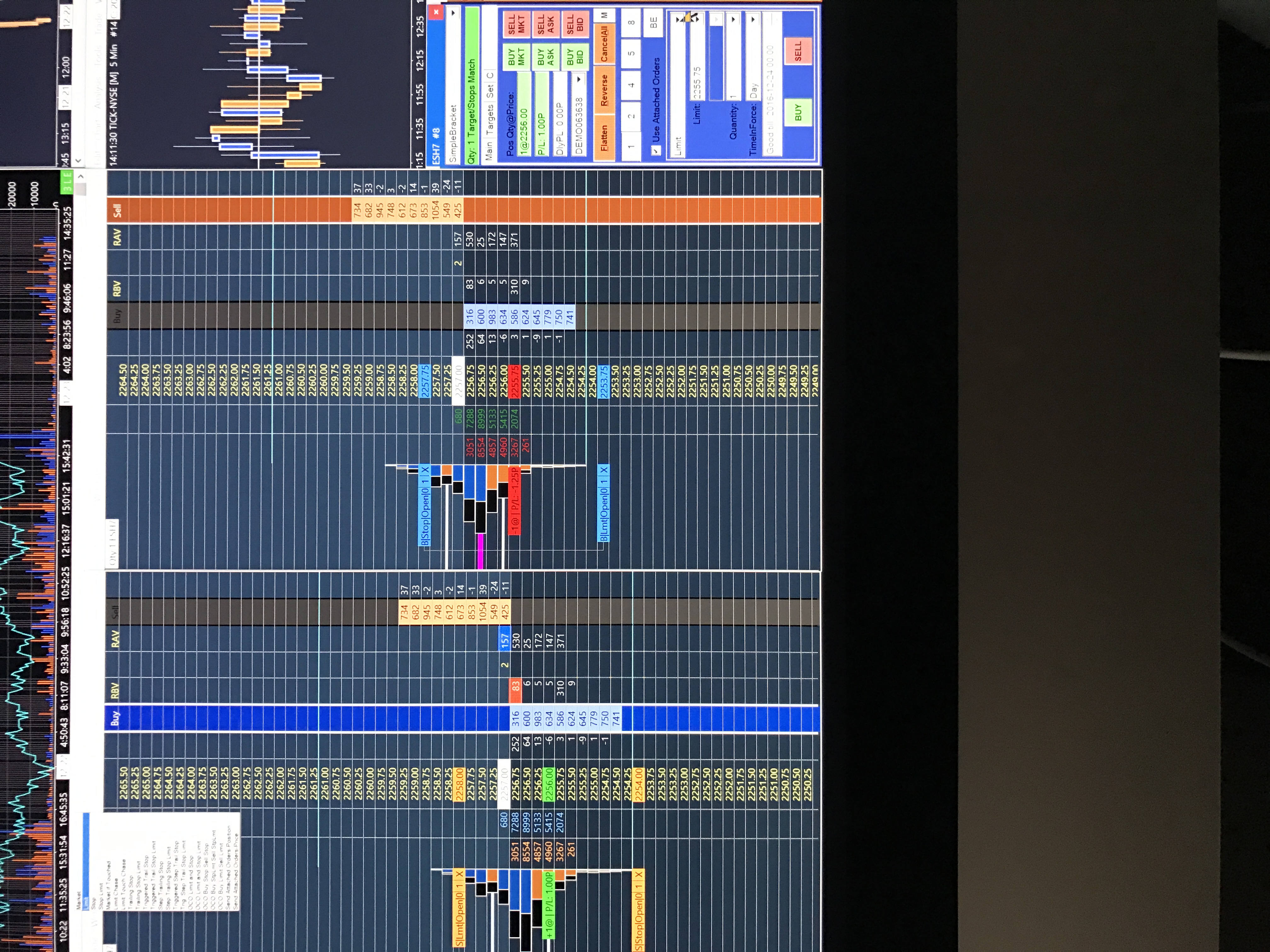

A little glitch with the latest version of Sierra, at least for me: My trade windows are detached from my DOMs and when I try to use the drop down menus on the trade window, the menu list actually appears within my DOM, not within my Trade window.

Specifically what menu are you referring to?
Are you referring to the menu that displays when you press the M button on the Trade Window?
Nothing has changed with this and we have no other reports of a problem.
[2016-12-23 19:22:09]
Dmac - Posts: 25
It's happening with any pulldown menu on the trade window. For example, take the attached image, notice the trade window bottom right, with my mouse pointer at the trade type pulldown where it says Limit Then look at the top left of the photo, that's where the actual dropdown menu is appearing. To make a change, I need to bring my mouse to top left menu.
imageIMG_0321 (1).JPG / V - Attached On 2016-12-23 19:14:55 UTC - Size: 2.87 MB - 412 views
[2016-12-23 19:41:05]
This must be an operating system level problem.
We have never seen anything like this before. We recommend restarting your computer.
There is no ability for an application program to cause that kind of behavior. It can only be happening within Windows.
Let us know if restarting the computer resolves this.

Dmac - Posts: 25
I restarted the computer. Menus are still acting this way.
[2016-12-23 20:18:23]
This does not make any sense to us.
We have never seen anything like this before. We would not even know how to even cause this behavior and it is not even possible to directly cause this.
We do not have any other reports of this. At this point in time we do not know what to say about this.
What we want you to do is to go back to version 1491 by following the instructions here:
http://www.sierrachart.com/index.php?page=doc/download.php#Rollback
And let us know if you still see this.
For the record, we have absolutely have never seen anything like this before and it utterly makes no sense to us. It is very very puzzling.
[2016-12-25 11:13:50]
Dmac - Posts: 25
No, unfortunately installing 1491 and restarting my computer a few times did not correct the issue. It did reset my DOM settings. I went back to version 1500 and will live with the menu quirks. They were not present prior to installing the latest version on 12-23.
[2016-12-26 17:41:45]
If you are noticing the problem with earlier versions and did not previously, then certainly it is not a problem with Sierra Chart. And we do not see how it could be anyway.
This must be some system issue. Possibly due to a video driver. We do not know.
It is also not possible for Sierra Chart to do anything to trigger the problem.
