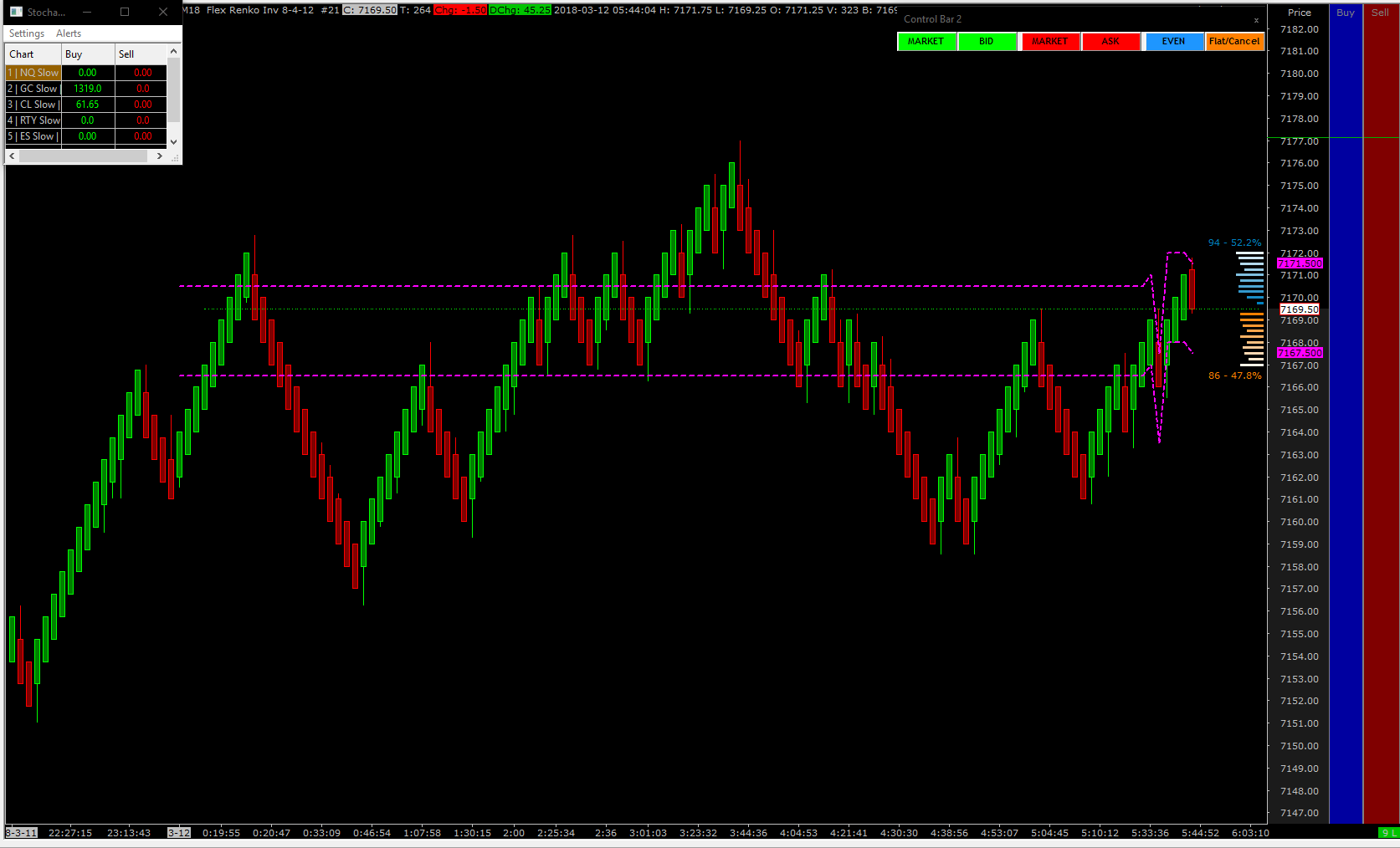

I found this study collection you created for another user when I was searching for something similar.
Thinking this would accomplish what I needed I tried it this morning and although the Study Subgraph Add does draw offset lines based on the Current Price Line study as you configured, the offset lines it creates don't shift up and down with the current price, they paint the prior price as the current price changes and quickly make a mess of the chart.
Is there a way to "bracket" an offset to the current price line study that moves up and down exactly like the current price line does without painting the line permanently on the chart? Ideally, including an Offset Input on the Current Price Line study would allow us to create brackets that move with current price if possible.
I've attached a chart to illustrate what happens when price begins to move with this current study collection.
Thanks much -- Scott

[2018-03-12 19:36:06]
This will be fixed in the next release.

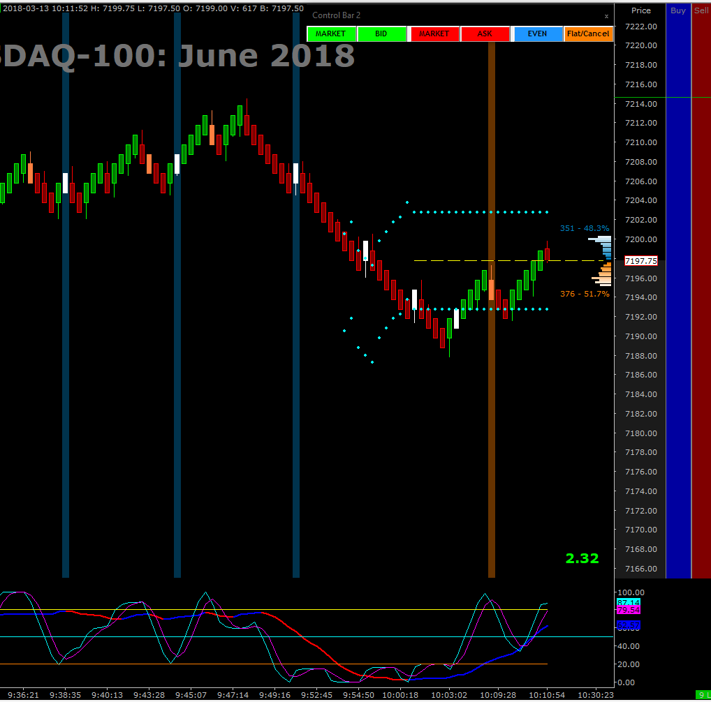

Thanks for addressing the study collection Engineering, I appreciate the quick response. However this introduced another issue. The trailing portion of the offset line now leaves a painted artifact on the charts as you can see in my included screenshot.
In addition, if there was a way to adjust the length of the Study Subgraph Add to be something less than the Current Price Line that would be PERFECT (although not necessary just a nicety).
Thanks again for all you assistance....Scott

[2018-03-13 19:12:05]
We cannot provide further help. You need to do your own custom programming to accomplish what you want.
[2018-03-17 08:45:28]
Also we did test this again just now and cannot reproduce what you showed in post #5.
