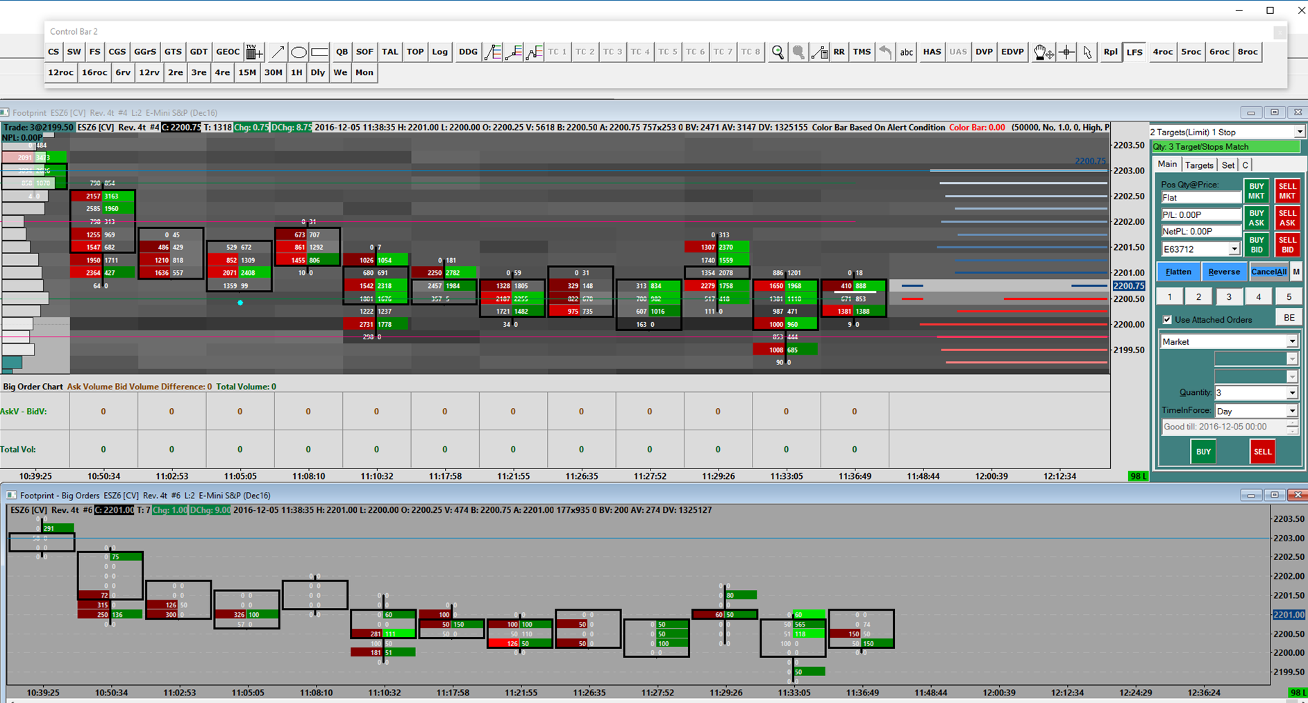

Ok. I have both charts setup but the numbers - calculated values study is displaying 0's. I've attached an image. I put 'yes' for reference other chart and I put the chart number for the chart with the filter. They are both on 4 tick reversal bars. Can you help?

[2016-12-05 21:30:55]
User104854 - Posts: 460
Disregard this. I figured it out. Needed to check the filter trade completely box. Thanks.
[2016-12-05 21:48:27]
No, you want to make sure that is unchecked.

We have had a look at this.
What we have determined is that the source chart, the one with the volume filtering, needs to also have the Numbers Bars Calculated Values study on it in order for it to maintain the necessary data arrays which are relied upon by the destination chart.
We are going to update the documentation to explain this.

[2016-12-06 21:11:22]
We cannot see any reason why there would be a problem and we do see the data:
http://www.sierrachart.com/image.php?Image=1481058578660.png
Do you see the nonzero values when you select Chart >> Recalculate?
