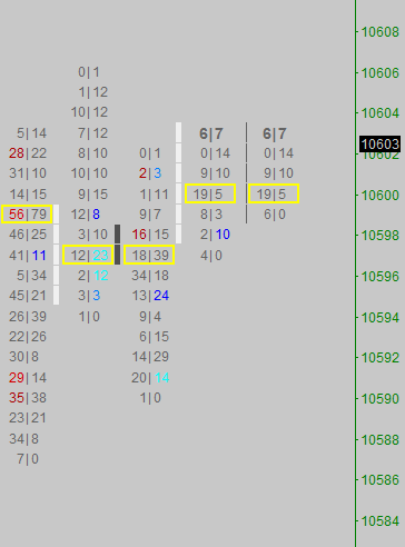

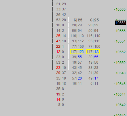

Hi there,
I'm running a number bars chart on the DAX with a pullback column enabled and I'm noticing, consistently, that the pullback column is not resetting on new bar highs. It was difficult to capture because the dax is moving quite whippy right now, but here is an illustration. pb_2 shows the same pullback column values after price has made a new high for the current bar.
imagepb_1.png / V - Attached On 2016-12-01 09:10:40 UTC - Size: 7.16 KB - 694 views
imagepb_2.png / V - Attached On 2016-12-01 09:10:50 UTC - Size: 10.08 KB - 652 views

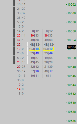

Another example - again, this is only a problem for up bars making new bar highs.
imagepb_3.png / V - Attached On 2016-12-01 09:23:13 UTC - Size: 9.51 KB - 506 views
imagepb_4.png / V - Attached On 2016-12-01 09:23:22 UTC - Size: 9.81 KB - 468 views
[2016-12-01 09:51:44]
Clearly the Tick Size and Value Format of that chart are not set correctly. You are creating your own problem. Those must be set correctly. You cannot alter them and expect Numbers Bars to function properly.
Follow the instructions here:
Global Symbol Settings: Update/Apply Symbol Settings to Charts

[2016-12-01 19:00:01]
OK understood. We do acknowledge that particular documentation.
However, upon a code review, the Pullback column is not going to function correctly unless the Value Format is set to what it actually should be. In this case it needs to be .1.

[2016-12-02 02:34:37]
The Price Display Format does need to be set to .1.
It does not appear as though that setting the Tick Size to a larger value will cause a problem.
