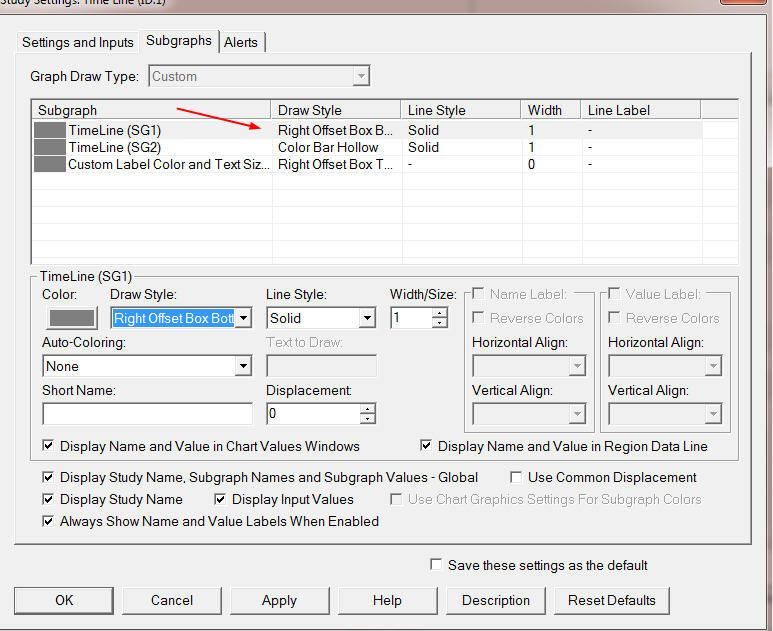

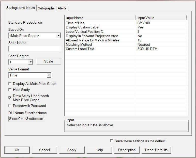

I can not get the vertical time line to show.
Do you see anything wrong with my settings?
Thank you,
image1a.jpg / V - Attached On 2016-11-21 01:29:17 UTC - Size: 197.13 KB - 575 views
image1b.jpg / V - Attached On 2016-11-21 01:29:27 UTC - Size: 90.57 KB - 476 views
[2016-11-21 02:41:33]
From our perspective this is hard to say. But try increasing the Allowed Range for Match in Minutes Input.

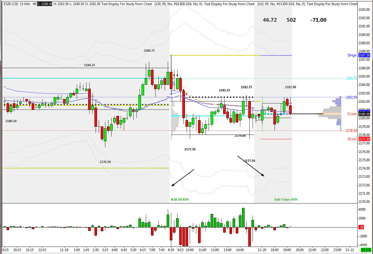

I simply want to have a Vetical line as shown in the screenshot.
A Vertical line is not a choice?
Thanks as always
image1.jpg / V - Attached On 2016-11-22 15:21:38 UTC - Size: 219.37 KB - 518 views

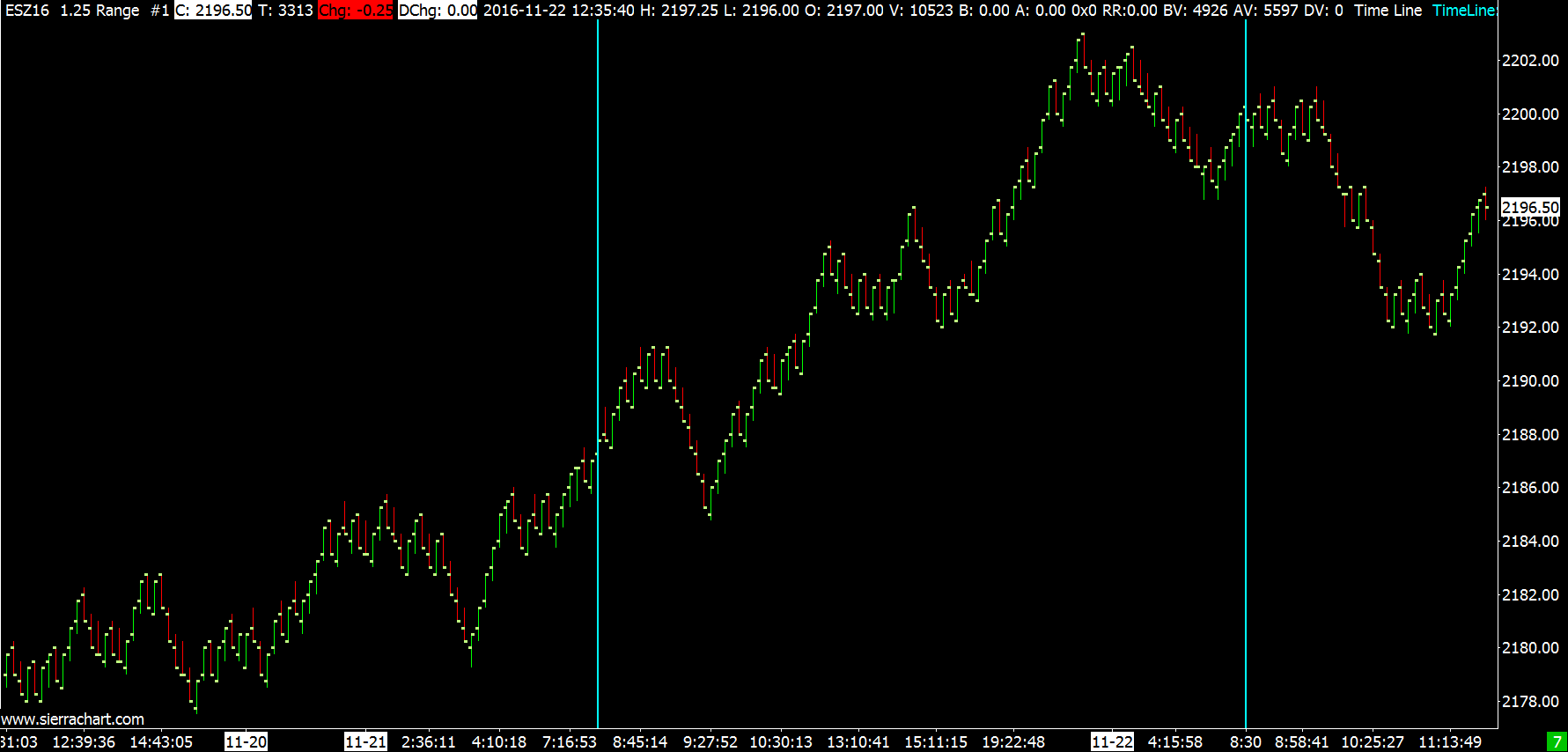

Using the same settings you have showed, we see the Time Line displayed on a chart for the same symbol and same bar period:
http://www.sierrachart.com/image.php?Image=1479840502513.png

[2016-11-23 01:55:55]
Rino - Posts: 124
Once again thanks.
Especially for taking the
time to duplicate my setting to show me it works.
Now you may be mad when I tell you what I did. The main
reason I am telling you is so if it happens to someone else, you know
what they probably did. Lol
I changed it to line. As long as you leave the default settings it works.
Truth be told. I changed it because I would not think I should leave it as
"Right Offset Box Bottom" I was changing that to line. (Because I wanted a line. Lol)
image1.jpg / V - Attached On 2016-11-23 01:54:35 UTC - Size: 112.66 KB - 406 views
[2016-11-23 05:04:08]
You are running a version where the Subgraph Draw Style list box is not displaying the correct text in some cases.
Update Sierra Chart to the latest version. Select Help >> Download Current Version.
