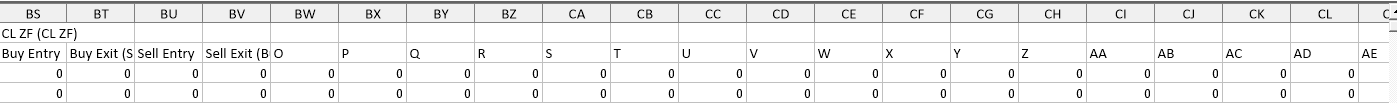

AB604E - Posts: 32
I have 39 studies including Alerts studies.
The cells BS-DZ will filled with Column header and the rest will be filled with ZERO
Please refer to the screenshot attached.
This spreadsheet is working fine with older version but I need the multi-account feature so I will stay with 1001.

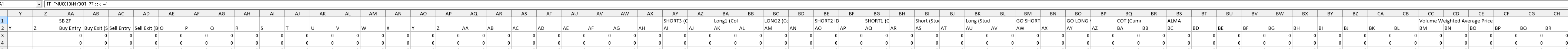

AB604E - Posts: 32
Do Not Output Subgraphs Set to Ignore == set to "NO"
Those ZERO are not from the studies, it is like extra column that being filled when load existing spreadsheet with Version 1001
What is affected is my BUY / Sell Signal that reference to those studies that being shifted to new Column.
For example. The BUY signal is reference to BK3,
after upgrade to 1001, BK3 become Zero and the actual signal is shifted to EA3
so what I did is manually change the parameter in each BUY/SELL to new reference which EA3
You can duplicate this by adding the spreadsheet for trading to the Blank Intra-day chart (only Price with no indicators)
Go to Setting of the Spreadsheet
Then Select spreadsheet Name:
(Browse for any existing spreadsheet that created with 9XX Version.
You will see that Column AA to CH will be filed with Zero.
This is not happen to NEW spreadsheet created with Version 1001.
imageCELLS2.png / V - Attached On 2013-08-01 09:59:29 UTC - Size: 26.58 KB - 802 views
