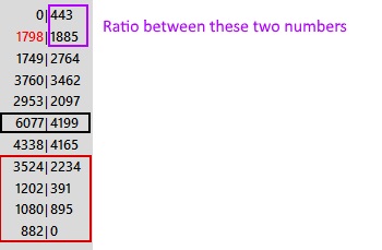

I´d like make an alert with these conditions:
if a ratio between the two top numbers on the ask side in bearish bar is greather than X, then do something... (draw a star, for example).
The problem is: is there any way, how Sierra Chart can calculate a ratio between the two top numbers on the ask side (or, reversely, a ratio between the two bottom numbers on the bid side)?
Thank you

This can be done by using an Alert Condition Formula on the chart:
Study/Chart Alerts And Scanning
These are the relevant functions you need to use:
Study/Chart Alerts And Scanning: Special Functions
