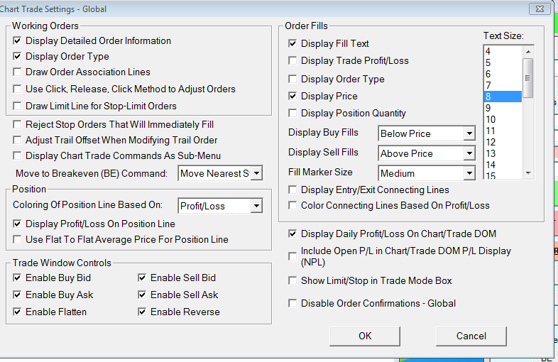

2. And somehow i have lost the triangles that are put on the chart when fills are recorded.
Is it done in the dialog attached?

[2016-11-08 03:35:31]
aydex - Posts: 110
So for #2, the attached Capture.PNG is the correct dialog, and from its setting, should be showing the fill triangles, I believe.
But its not.
Let me just work backward for a sec, what turns off the triangles that appear when a fill has been made?
[2016-11-08 03:42:17]
This is explained in the instructions here:
http://www.sierrachart.com/index.php?page=doc/ChartTrading.html#DisplayingOrderFills
