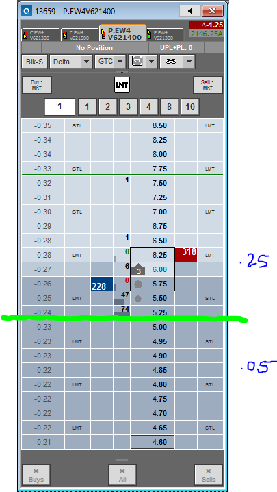

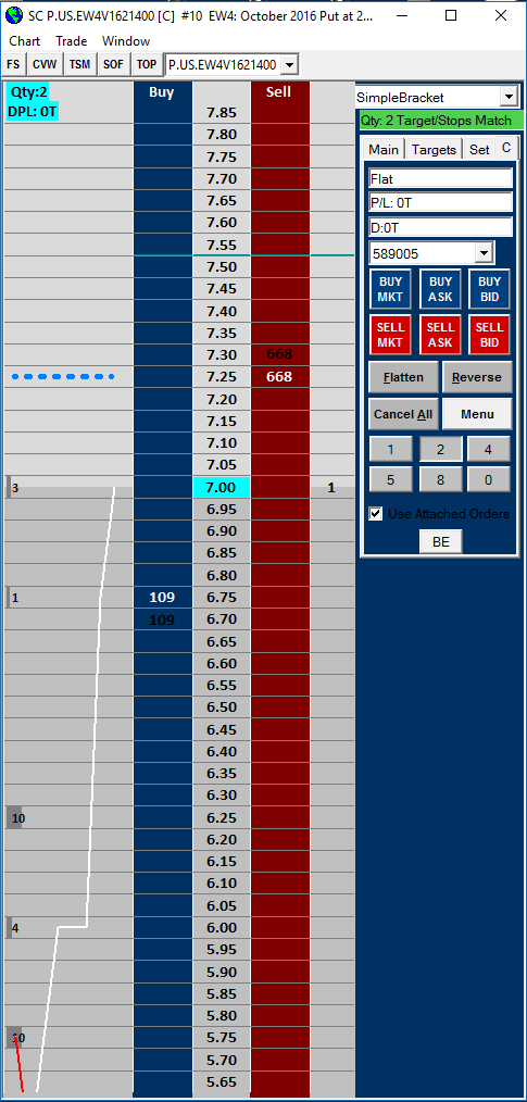

I am running CQG feed and testing options on the Sierra DOM, but the tick increment that displays on the DOM is incorrect. ES options are priced at .05 tick increments only for those options priced under 5.00, everything else is priced in .25 increments. Since yours are priced in .05 increments all the way up, there are 4 dead tick zones between each tradeable price. This is the case with all strikes for ES.
So for example an option strike that should be 10.00, 10.25, 10.50, 10.75,11.00 etc is priced as 9.95, 10.00, 10.05, 10.10 etc which are not tradeable prices other than the 10.00 value.
5 cent tick increments are tradeable at 5.00 and below, so 4.95, 4.90 etc are valid tradeable prices.
imageSierra options on DOM.PNG / V - Attached On 2016-10-25 13:15:11 UTC - Size: 44.86 KB - 470 views
imageCQG options dom.PNG / V - Attached On 2016-10-25 13:15:45 UTC - Size: 32.73 KB - 476 views
[2016-10-25 17:21:07]
You just need to manually change the tick size to .25. Refer to:
http://www.sierrachart.com/index.php?page=doc/ChartSettings.html#TickSize
[2016-10-25 18:12:05]
Japhro - Posts: 120
Yes, if I disable "Auto set from data feed' and change it to .25 tick increment that works for options well above 5.00 but it doesn't change the fact that ES options are priced in .05 increments under 5.00 and .25 increments above. so as the options strike moves above and below the magic 5.00 number if becomes very difficult to trade with a fixed .25 tick increment. These are not exotic options, they are probably the most liquid futures options available
Date Time Of Last Edit: 2016-10-25 18:12:36
[2016-10-25 18:15:40]
Sierra Chart does not offer a way to automatically change the tick size based upon the price.
The data feed probably does have different tick sizes for different price ranges, and Sierra Chart could choose the correct one at the time it is automatically set, but once it is set it will remain.
