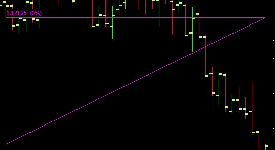

[2016-10-24 12:49:24]
User429169 - Posts: 14
How to remove this slope or slant (attch).
Thank you.

[2016-10-25 10:58:49]
Can i have multiple more than 2 or around 5 retracement on terminal in different locations, Like top, bottom, right, left.
Yes.
We do not see a variable to remove the main line of the Retracement drawing.

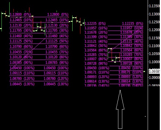

[2016-10-26 10:58:22]
Yes, able to display all the retracement levels at different loactions. Actually this for some study purpose.
Why the screen is moving up after levels added. How to display this levels without screen moving above.

[2016-10-26 17:15:03]
It looks as though there is a study which is being displayed in Chart Region 2 which is not displaying anything. Refer to:
http://www.sierrachart.com/index.php?page=doc/ChartStudies.html#ChartRegion
[2016-10-27 06:52:01]
sc.GraphRegion = 0;
This is missing, now it's working.
Thank you
