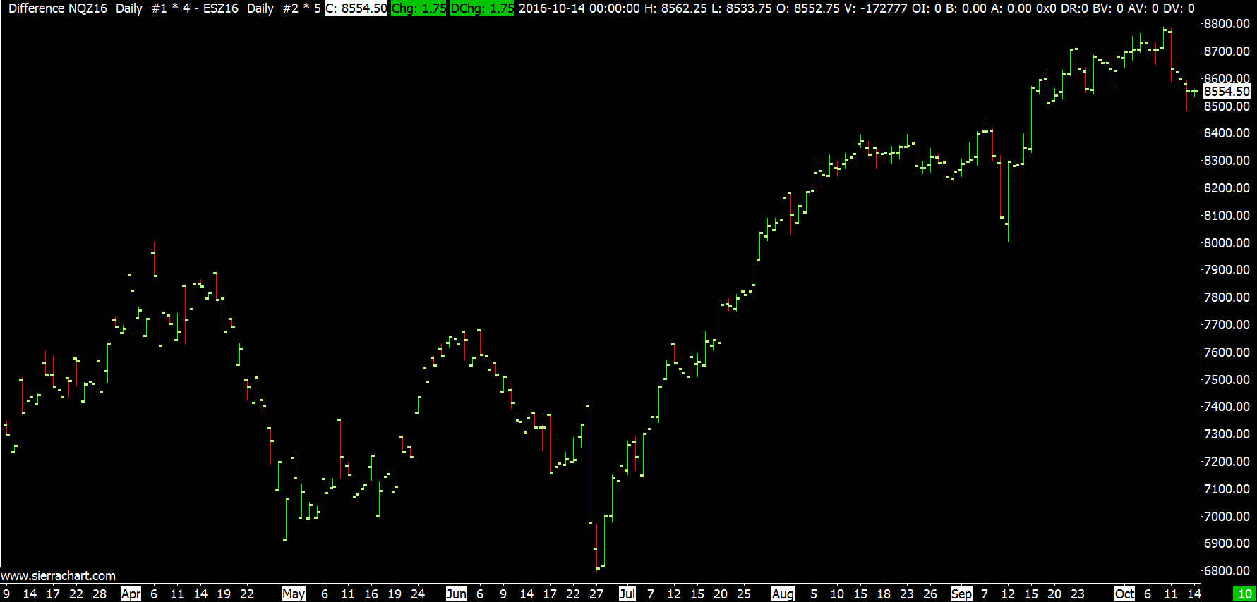

[2016-10-14 04:18:02]
This is what we see:
http://www.sierrachart.com/image.php?Image=1476418605373.png
This consists of Historical Daily charts, but you can always set the chart bars to an Intraday timeframe.
