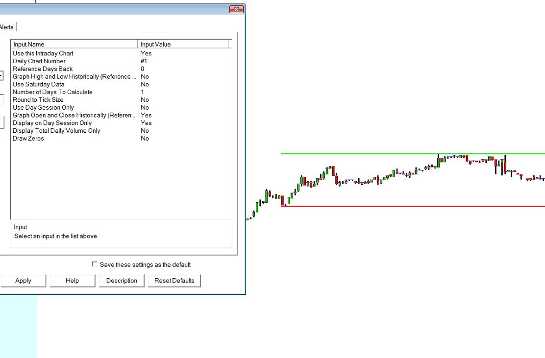

[2016-11-25 03:17:40]
aydex - Posts: 110
Getting back to the Daily OHLC study
I had this working at one point, and now its not
The high and low are being drawn without the incremental changes, with 2 horizontal lines
i wish the lines to be dynamic, as they change throughout the day
is it that i just need to redraw, or recalculate, as i had put the study on much later in the day, and not from the session start.
imagedaily.jpg / V - Attached On 2016-11-25 03:17:17 UTC - Size: 57.43 KB - 459 views
[2016-11-25 03:55:52]
This is explained in the documentation for the Daily OHLC study here:
https://www.sierrachart.com/index.php?page=doc/TechnicalStudiesReference.html#s137

[2016-11-25 04:29:05]
aydex - Posts: 110
1. yes in the attached daily.jpg, the Graph High Low Historically study Input is Yes.
The Reference Days Back study Input is set to 0
2 Sorry, should have added some details, the sudy im looking for would show 2 horizontal line extensions (towards the right side of the chart) that begin at the high and low of the session's first bar
[2016-11-25 04:36:43]
1. We see it is set to No in the screenshot.

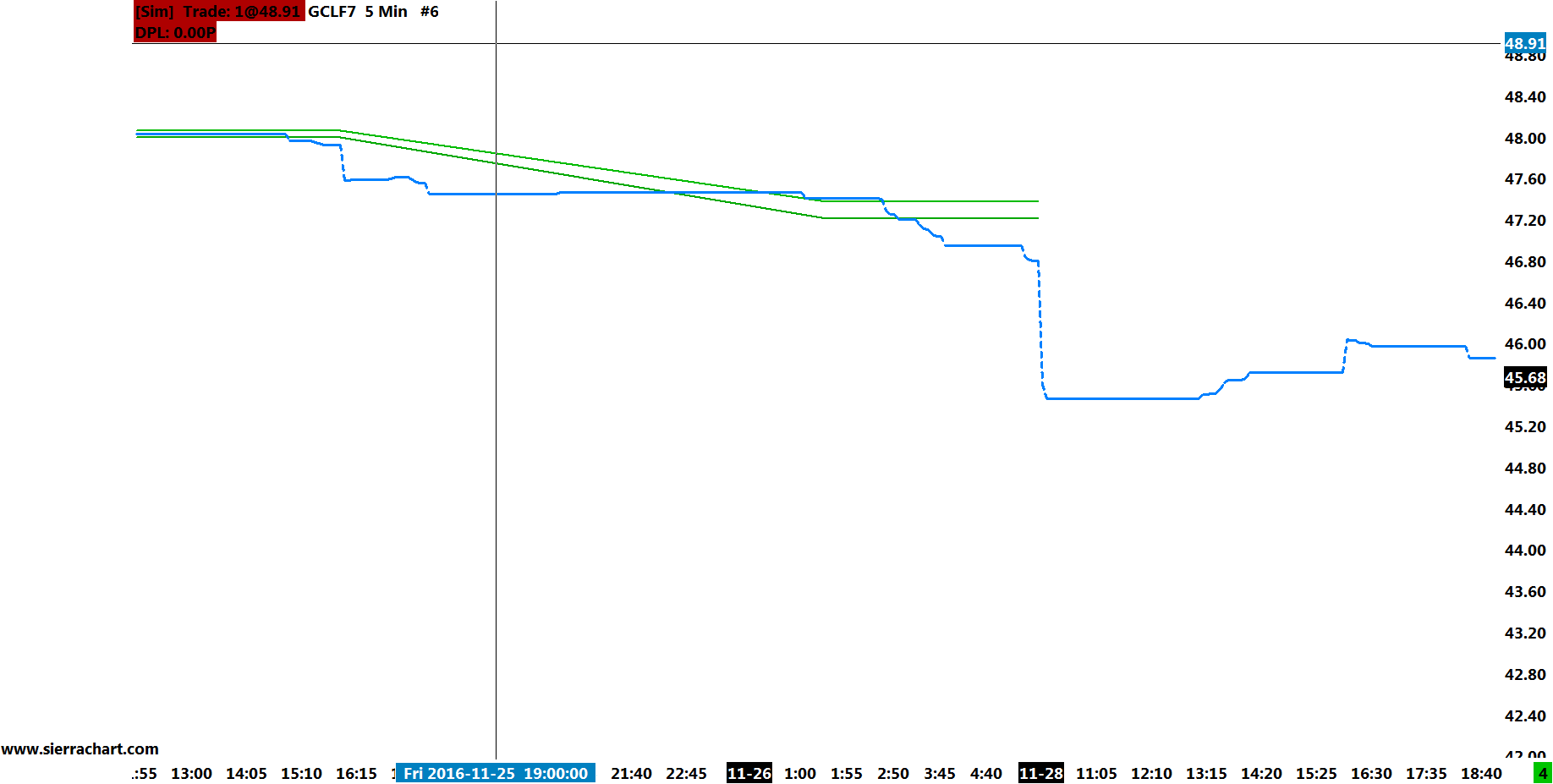

[2016-11-28 07:59:39]
aydex - Posts: 110
1. sorry youre right there was a 2nd similarly named setting
2. High/Low for Time Period-Extended is looking good
just was wondering if there is a way to unlink separate days
b is when only one day is shown by itself, and a is when two days are shown
is the a way to remove the "ramp" from one day to the other?
a
http://www.sierrachart.com/image.php?Image=148031977526.png
b
http://www.sierrachart.com/image.php?Image=1480319662270.png
[2016-11-28 18:24:20]
You just need to change the Draw Style to something like Dash:
http://www.sierrachart.com/index.php?page=doc/ChartStudies.html#DrawStyle

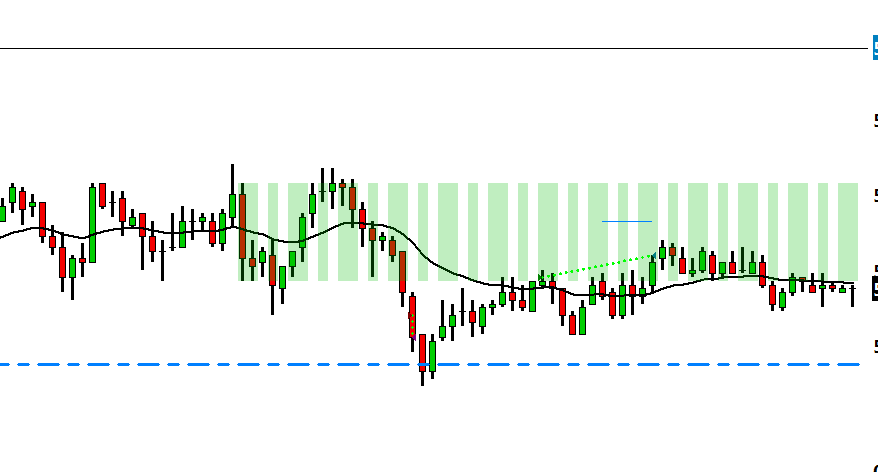

[2016-12-05 20:43:43]
aydex - Posts: 110
Hi
I'm having problem only on my Crude chart, my gold and es charts i'm not seeing following problem
I have price/overlay study on a 3 minute pointing to green range and blue ohlc studies on a 5 minute chart
Instead of transparent fill top and bottom, the fill looks like vertical bars, and the ohlc solid line is also broken up similarly
as in snap
when i change the 3 bar period chart to 5, its appears ok, and in fact any period over 5 is ok, and any number under 5 is broken up
this is not happening on the other ES and gold charts, (with their links to price overlays)
j
imagedd.PNG / V - Attached On 2016-12-05 20:37:49 UTC - Size: 22.11 KB - 470 views
[2016-12-05 23:13:30]
This makes complete sense because there are a fewer number of bars matching from the source chart to the destination chart.
[2016-12-05 23:48:12]
aydex - Posts: 110
I don't understand, as its working for any time period with four other contract pairs, just the crude is causing issues.
Here
http://www.screencast.com/t/y14kqGiT
First is the GCLF7 (Crude) issue with periods above and below 5 minutes
Gold is then seen working fine with periods above and below 5 minutes,
Interesting that when the period is lower than 5, Gold, GGCG7, takes a couple seconds for "calculating studies", shows the same vertical bars as crude does, but only momentarily, and then fills out the range.
On the ES chart, it just works with any period, without the momentary "calculating studies".
would it help if the chartbook was sent to SC support?
[2016-12-06 22:36:43]
Set this Input with the study to Yes:
Study/Price Overlay Study: Fill Blanks with Last Value
Not sure if that is what you are looking for, but that is all we can recommend for something like this when there are fewer corresponding bars in the source chart compared to the destination chart
Date Time Of Last Edit: 2016-12-06 22:37:27
